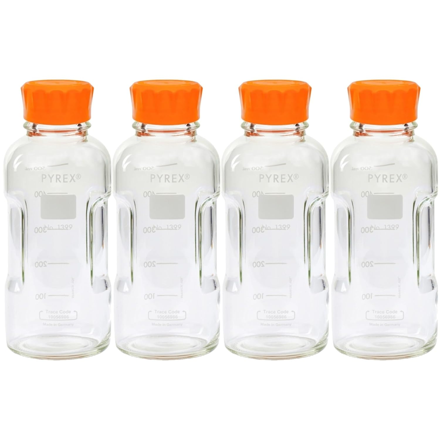

I've ordered 4 of these glass bottles for dividing up 2L of developer at a time. That would still leave me mixing bleach, fix, and rinse, but those are not quite as nerve racking with their volumes.
These bottles do have some airspace but I have a can of wine saver gas if I decide to use it.
Fill up three of them to close to the rim.
Then use the inert gas on the 4th, and on each bottle as you open it.

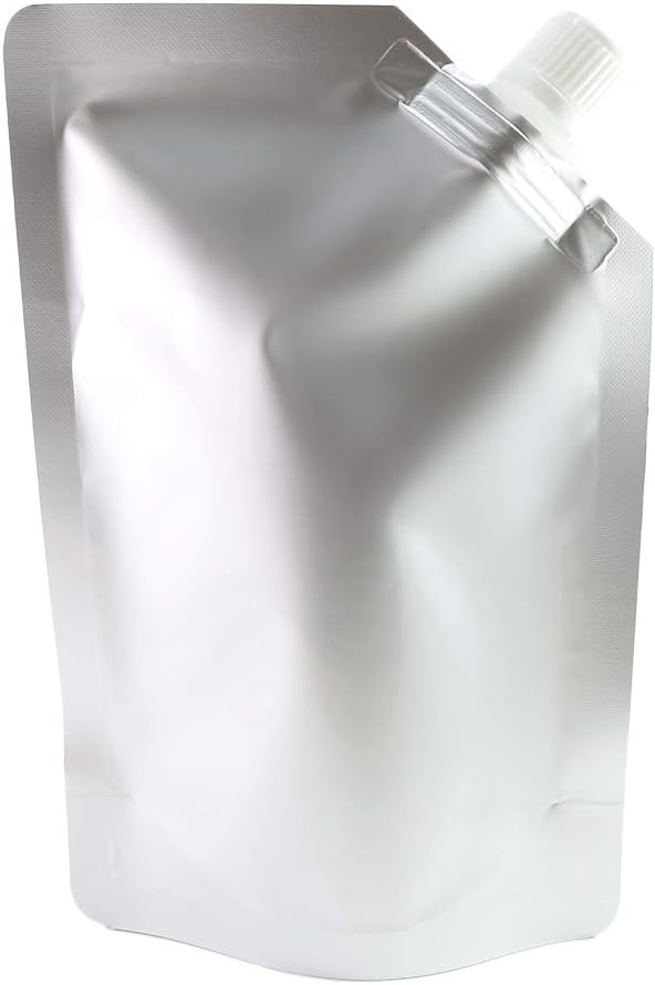

Try these 500ml wine bags: air and light tight. And I re-use them as well. You can find them on amazon or ebay.
And you will also get the enjoyment of the user reviews, which extol their use for smuggling discount alcohol on to cruise ships by hiding filled ones in people's clothing - apparently even in bras!
People are amazing!
I use something similar to store mixed from powder B&W photo-chemicals.
