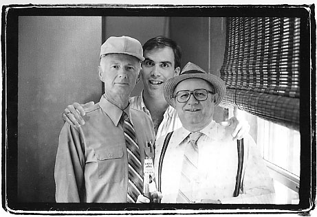

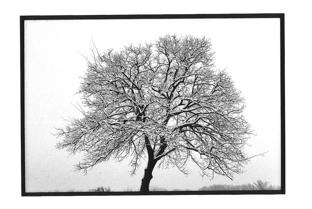

I almost never include the rebate in prints, however, I do have some negative carriers that allow this for those cases where I think it will work better.
This is one example. The first print lacked something. The sky blended into the border of the paper.
ic-racer
ic-racer
Feb 25, 2007
16,544
USA
Next I used a different negative carrier which allowed the rebate to be printed. The black border framed the print better in my opinion.
These both are printed on 8x10 paper with about 1" border.
Also, the edges of this particular negative carrier are not that aesthetically pleasing, so the edges are cropped out. I do have some carriers with filed out edges that look nice, but I would have had to change enlargers to see that one. I was pretty happy with the smooth outer border on this print.

BTW, the lens is Nikonos 35mm lens. Yes, underwater camera. A fantastically sharp lens used out-of-water.

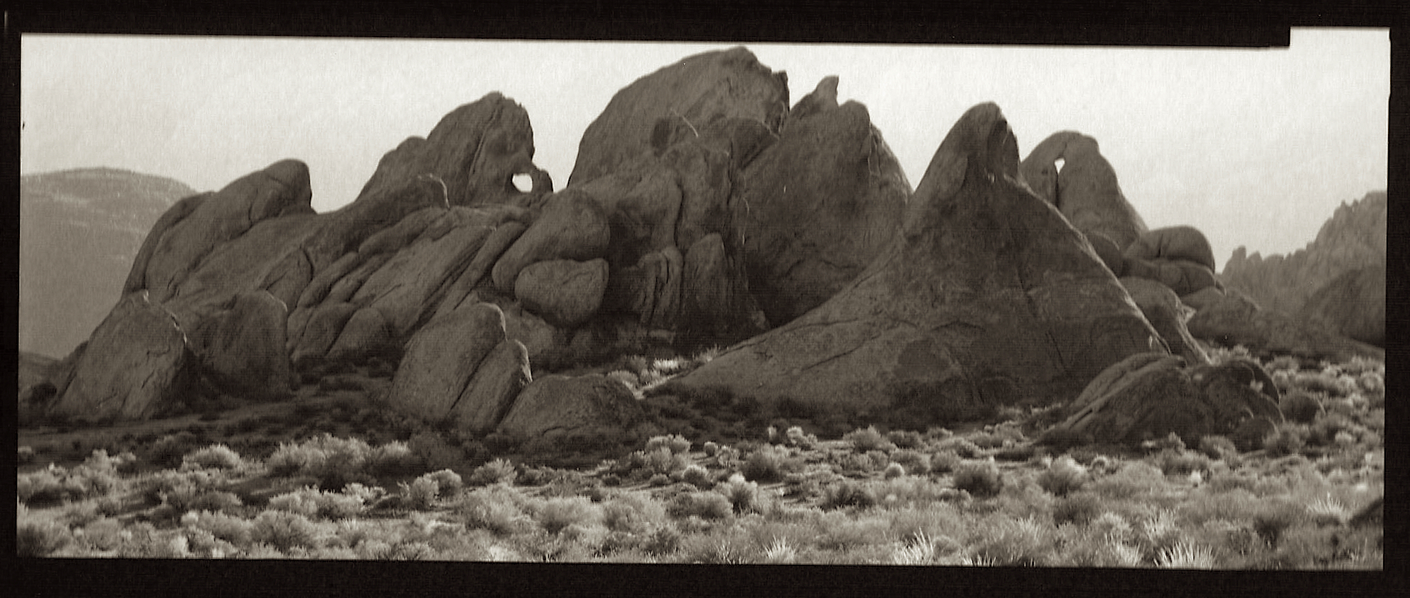

Works. It is a solid option...but it can be image-dependent.
While the rebate does frame the sky for you, it also changes the relationship the tree trunk has with the bottom of the frame. The trunk is rising out of the bottom of the frame (w/o rebate), and on the second image, the tree is resting on the rebate -- more contained within the frame. Different, not better/worse.
In the below case, the rebate helps to hold in the 'sky' (actually the eastside of the Sierra Nevadas). With a little tension tossed in on the top of the frame. 4x10 platinum print
Edit: The window mat would be cut to leave just a touch more than the actual film area showing

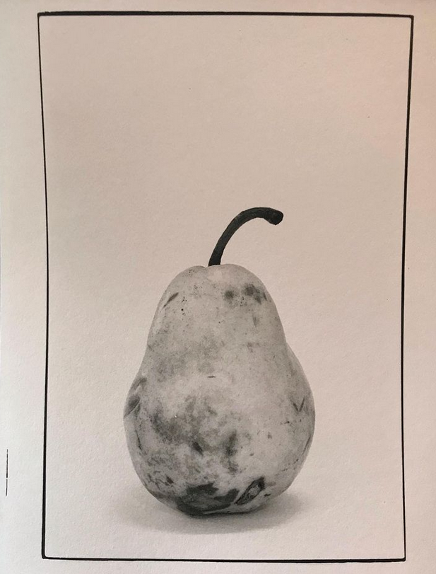

I will sometimes print a thin black rectangle around 35mm enlargements. And contact prints. But not medium or large format enlarged.

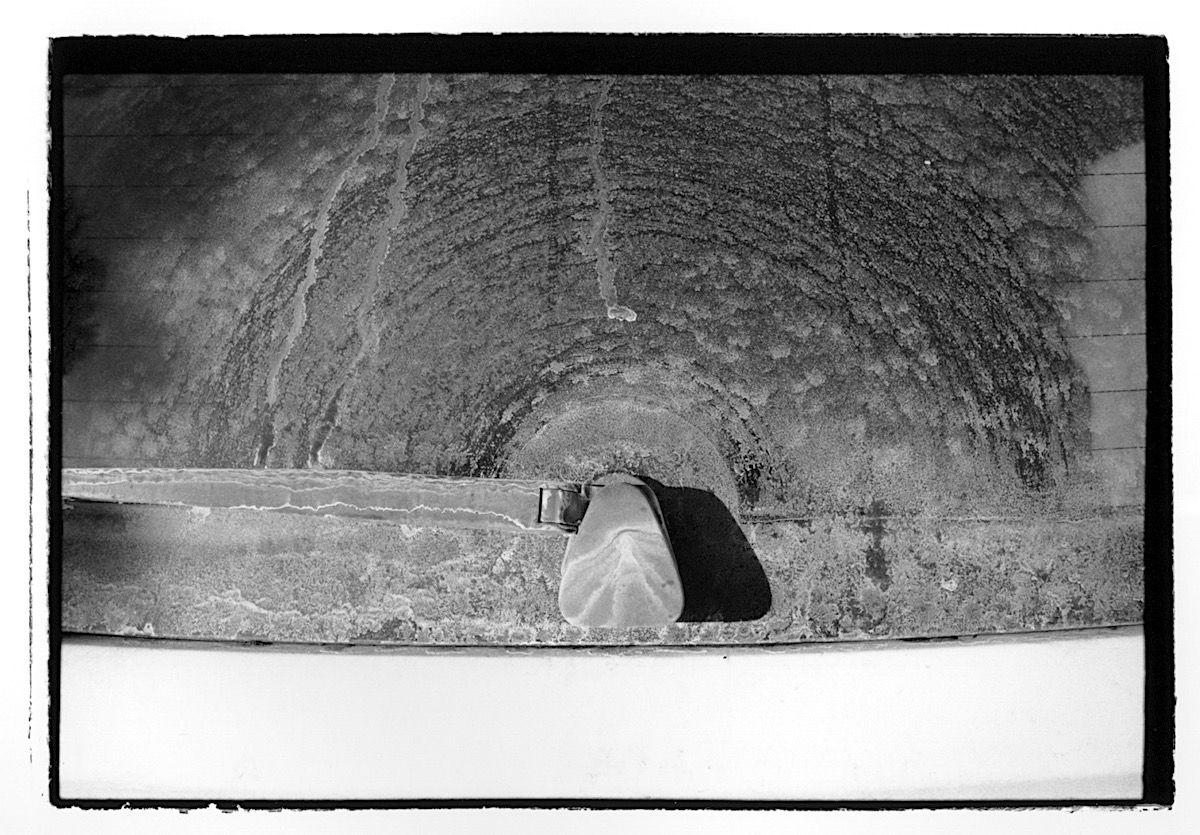

Another, that in my opinion benefits from the edge treatment.

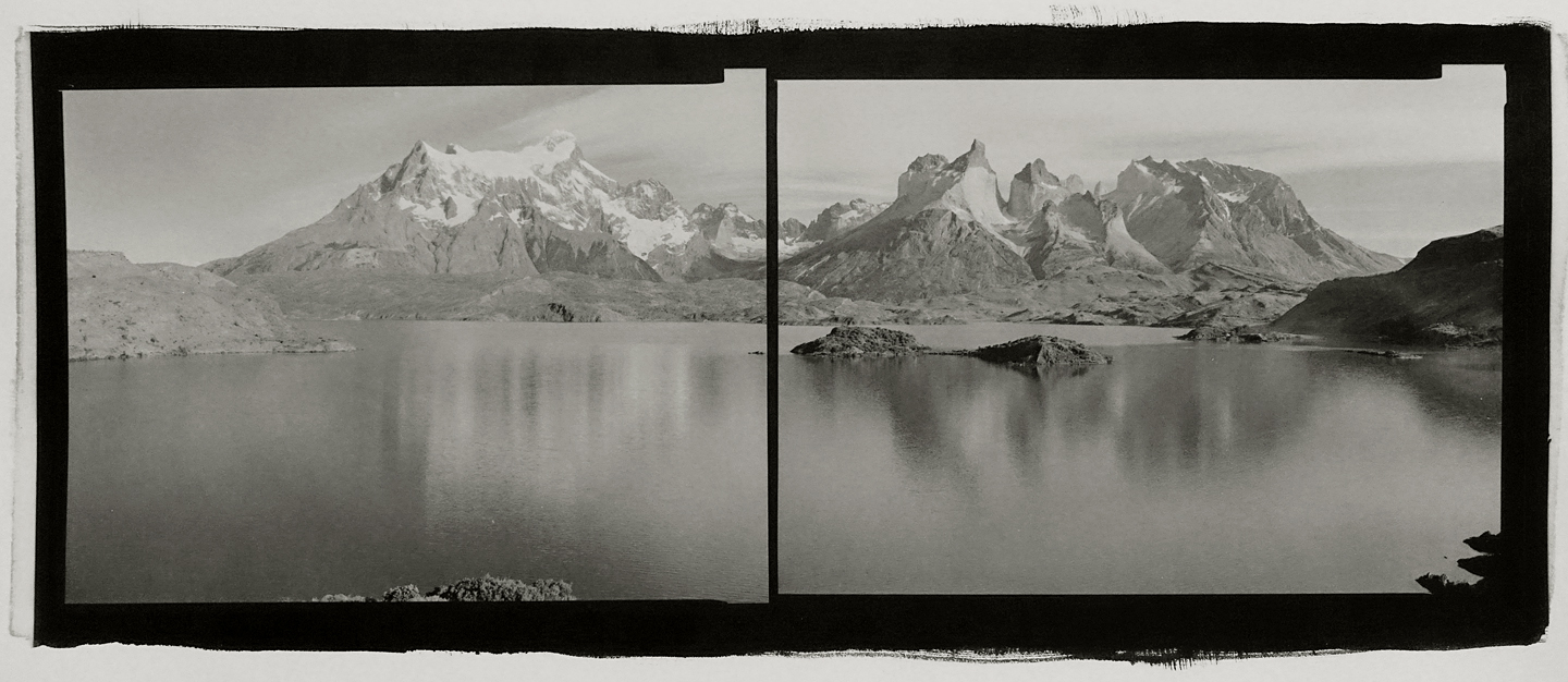

Cut, stitch, hammered, and glued...
If ya can't (or do not want to) haul an 8x10 to the other side of the ball, a couple of 5x7s will have to do. 80 sq inches vs 70, but its tough to get everything.
