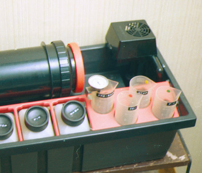

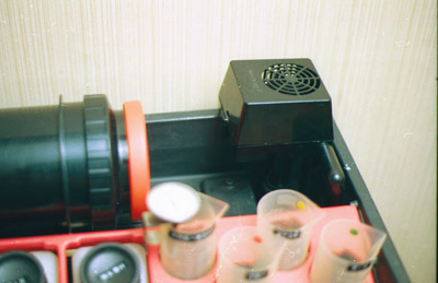

One gripe that I've always had with the Jobo CPE 2 is that there is no circulation in the water bath. This means that while the water immediately surrounding the heating element and sensor warms up very quickly, the rest of the bath remains barely changed. You can try to stir the water around by hand to keep it even but that is inconvenient and ineffective especially with all the bottles and graduates in place. My solution was to mount a small aquarium water pump to one end of the unit where it pulls in the water and then sends it to the other end of the water bath via a flexible tube. The water has to to circulate back past all the chemical bottles and the heating element, keeping the temperature even throughout the entire bath. Now, with the pump running I can stick a thermometer anywhere in the bath, including in among the bottles and get the same reading. This brings all of my chemistry up or (in the Summer) down to temperature evenly. It works great and if you slapped a logo sticker on it, you would think that it is an expensive Jobo accessory. Here's a couple of pix (there was a url link here which no longer exists) . If the link doesn't work, they are in the non-gallery

I'm not an aquarium buff either. I bought that pump years ago for another photographic project. As you can see from the picture, my pump expells the water out through a tube. I can run it down to the other end of the CPE so that it can circulate back past the heating element and solution bottles. The new pumps that I have seen all seem to dump the water back into the tank like a waterfall. You might have to look around a bit to find one that is suitable.
As far as volume. All you are trying to do is move water around. I think that anything for a small aquarium would work fine.

I've used the add on pump on the CPE2. It doesn't speed up the process but even out the temp from the first left bottle to the last right graduate.
The pump is a really cheap aquarium one, inmmersed under the electronic box, and pushing water into a tube whose exit is at the right hand end of the bottle rack.
I advise you not to over flow the CPE2. When filling, put enough water for the processing drum to be into the water WITHOUT floating. If you put too much water, the right end of the tank will be higher than the left one, causing the right hand end of the film/paper to be out of the chemistry... And you'll waste products and time ! Been there, done that....

Here you go Dorothy.
I couldn't find the files on my computer but it took me about a minute to put my hands on the negs :smile:
