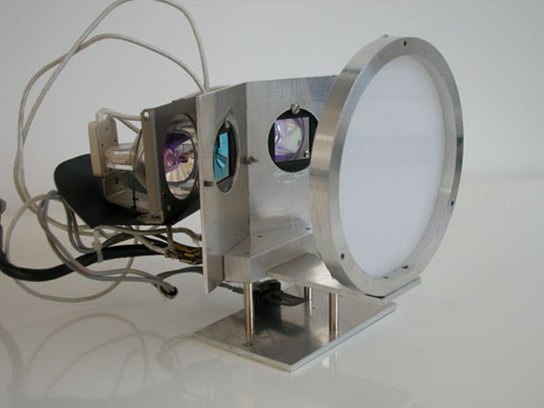

Is anyone aware of possible bulb replacement types for the Ilford 400 Multigrade head? Mine has ELB's (30V, 80W, GX5.3 base) and they should be easy enough to find. However, they're only rated at 18 hours and I'd like to find something possibly a little more long-lived.

The head I have is actually one which was rebuilt by Glennview to replace the bulb socket in a Durst 138, so it's a little different. No reason, to suspect that the bulbs in it are not the same as the original spec. I'll replace both and see how it does.
Just curious, since this head's been radically modified, does the original Ilford 400 head include a fan? (The Ilford 500 head does have a fan, which is why I'm prompted to ask.)

Not to worry. The socket assembly on the Durst is removable, held in by two thumb nuts. The modified Ilford bit sits in place of the original socket and has its own sockets which are correct for the ELB bulbs. It's pretty strange looking...
I checked with Webster, but they don't show them on the store listing. I emailed. If they don't have them, there are other suppliers who do. Of course, I won't have them until next week and vacation is this week. Oh well.

they have them, i always email them. and the thumbnail looks like the bulb housing
