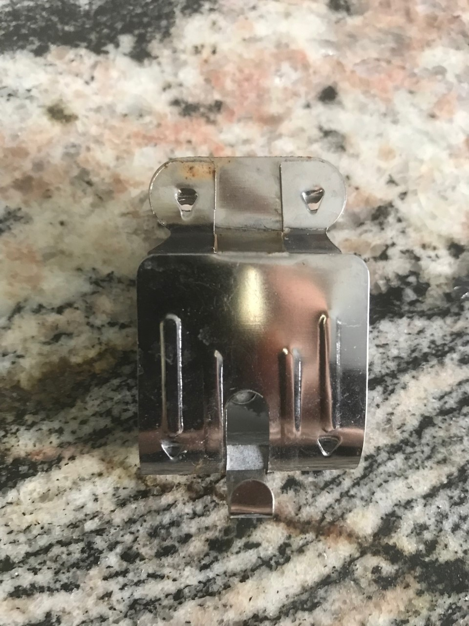

To avoid the longitudinal curling use a wide clip top an bottom with or without shower steam.
GregY
Apr 12, 2005
3,142
Alberta
Those are the clips I use for the top, but I use lead weighted clips on the bottom. I have never had curl with Ilford PanF+, HP5+, FP4+ or any of the Delta films.
