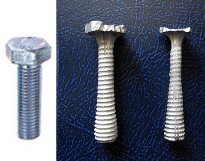

    Regular maintenance of Ilfochrome processors is a must, there are many components that need regular checking especially in the Bleach bath. I have attached a sample of why regular maintenance is a MUST. in the picture attached I show a normal Bolt for a bleach rack on the left before it has been installed into a processor. The 2 screws on the right are from 6 months exposure to ilfochrome bleach. note how the bleach has dissolved the screws. If such corrosion isn't seen to this can cause huge problems to the machine. parts need constant replacement. I think this is a good example as to how strong the chemistry in this process is.

    The picture looks like plated steel. If it is, try stainless steel.

    I should have made mention the bolts supplied by the makers are special titanium alloy designed for those machines. The normal stainless steel bolts are lucky to last a week in the bleach. titanium alloy lasts about 6 months.

    Ouch! I thought of mentioning titanium but it's expensive and hard to find.
    Polymer maybe? Or not strong enough?

    There are stainless steels that can withstand sulphuric acid.
    Though with the actual bleach solution things may change.
    Stephen, depending on the severity of this issue you might try to get samples of higher resistance steels and if it works get those parts off stock or having them machined.

    the corrosion issue isn't a problem I just take it as part of the process, one thing i am about to start is that at the end of each day removing the bleach racks and letting them soak in water overnight to slow the corrosion down, but as i mentioned I have hundreds of spares for exactly this issue. thanks for the heads up on certain stainless steels that can withstand sulphuric acid I didnt know this.

    Stephen, what material is the bolt screwing into, where, and what function ? I have quite a bit of experience of working with highly corrosive boiling acids (I built gold refineries).

    The bolt photographed goes into the rack supports for the bleach. the rack supports are made of plastic. and the corrosion is not a problem with regular maintenance. I simply posted the image of these screws as an example of the strength of the bleach on machine parts over long periods of time.

    OK, get some bolts made from Polypropylene or PTFE, or whatever the racks are made from. They can be made very easily, and they won't cost much at all.
    I used to buy filter housings from the US, the types used in some photo-labs, the steel nuts & bolts used would corrode badly, in the end I had my own filter housings made and that was the end of the problems, and the cost dropped substantially.

    The continued dissolution of metal into the bleach will have some effect even if it is only the buildup of sludge. I would keep a close lookout for particulate matter and decreasing bleach activity with buildup of stain in white areas. Just be on the safe side.

    I would find plastic substitutes as well. It almost seems like maybe there is a dissimilar metal electrolysis going on as well as a simple chemical action. If you pull the racks frequently and rinse them down do you have the same problem? Maybe part of the issue is a low grade stainles alloy.
