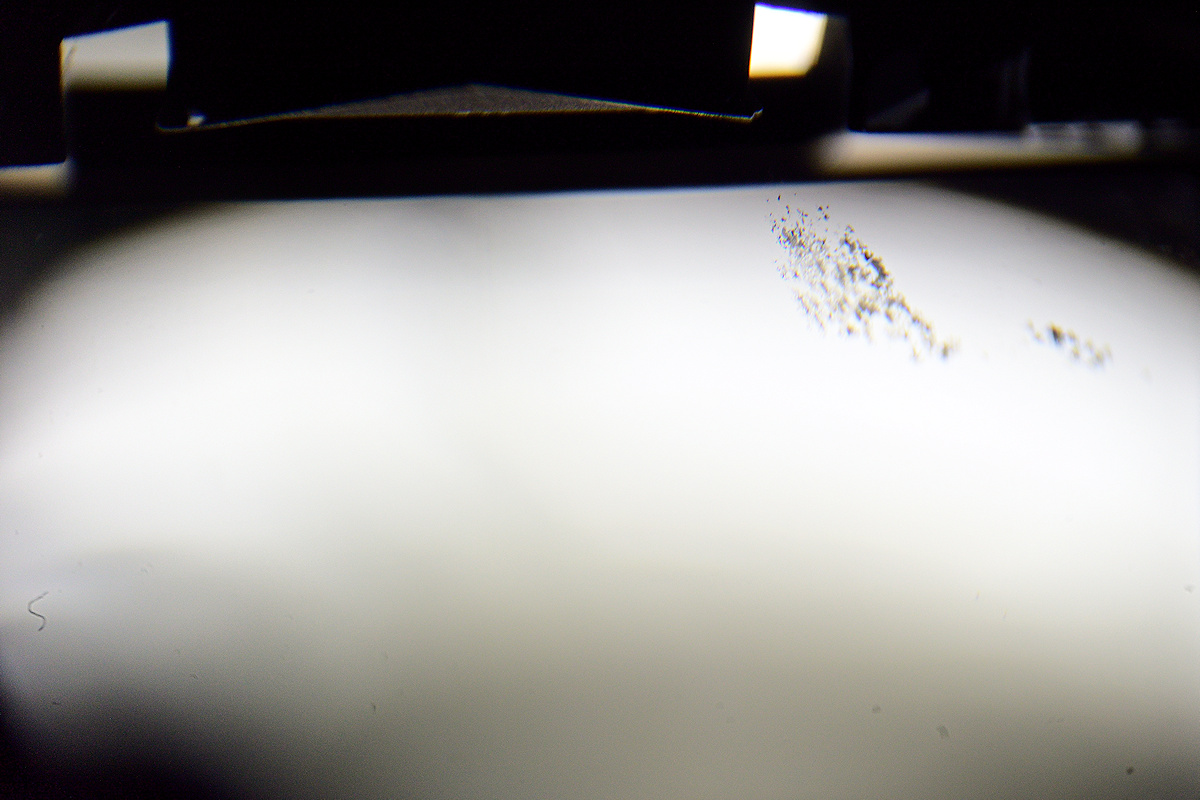

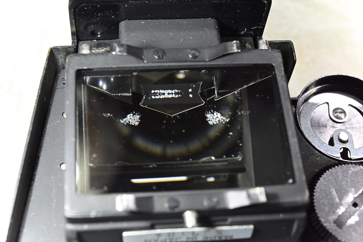

If you see such a cloudy spot through the eyepiece
and the cloudy spot is visible twice from the ground glass side
you have no real chance of removing it.

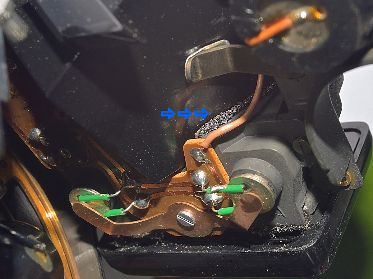

It is the decomposing foam strip that has attacked the black paint of the prism.
You would have to remove the prism, remove all the paint, clean and repaint the prism, and replace any deteriorated foam strips when reassembling the viewfinder. 😡

Forest. If the damage is superficial, meaning that you can touch it with bare hands, it IS repairable.
If it's inside the prism, that's still repairable via disassembling the prism itself. I do NOT recommend doing it, for few reasons: the prism was glued at the time of manufacturing; by de-gluing you run a fair amount of risk to brake it; and last, if all went good to that point, re-gluing is a process where calibration and special tools are needed.
