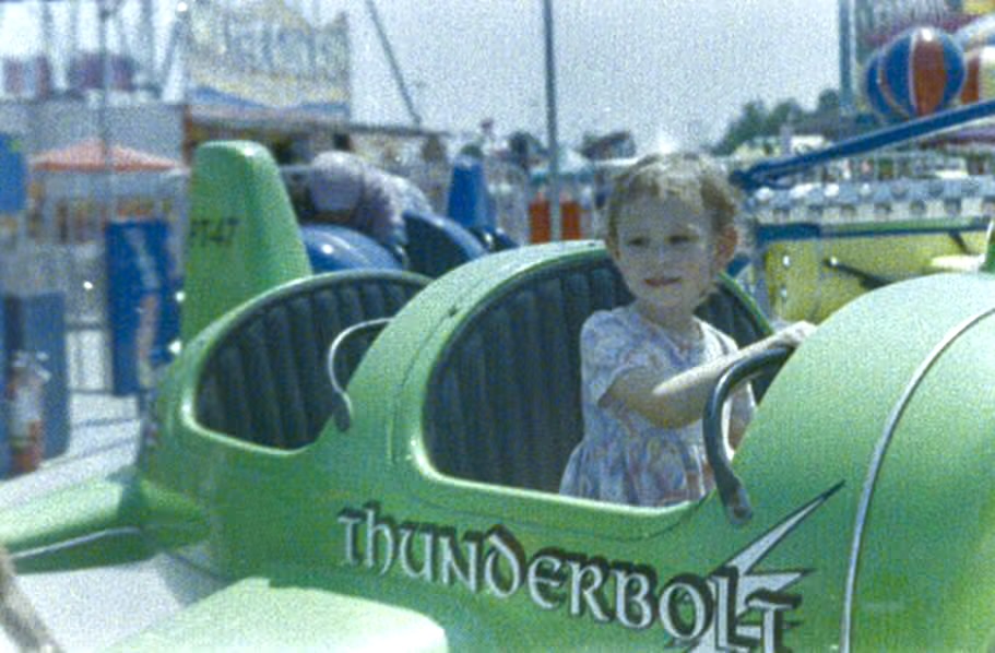

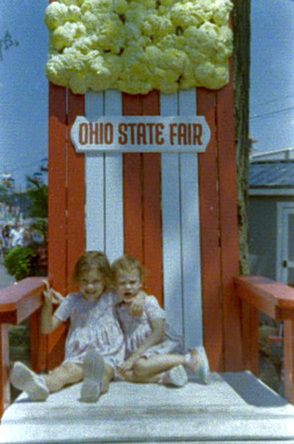

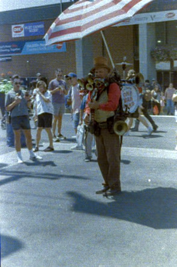

Your prints look in all honesty rather flat and desaturated with low contrast and dmax. Either your exposure times are consistently on the short side due to thin negatives, or (more likely), your developer lacks the 'oomph' of a commercial developer and you need to develop much longer, and/or may never get good density and saturation with it due to the formulation.

The low contrast and saturation is a negative issue. Entirely my fault. I got impatient. My chemistry wasn’t hot enough, so they’re underdeveloped. Even substantially compressing the curve, my digital inversions aren’t much better. I have another roll that’s much denser.
