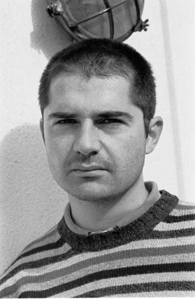

Last night I have finally developed my first BW film :smile:
I want to then the APUGers who've helped me with the selection of the equipment for my darkroom!!!
The film/develper combo is Kodak Tri-X (rated at 400) and Rodinal (1+50). Everything has gone smooth; even loading the reels wasn't so difficult after practicing a little with an old roll. The only thing I messed up has been the stop-bath, which I disposed into the sink instead of putting it back into the bottle after using. Not such a big deal anyway....

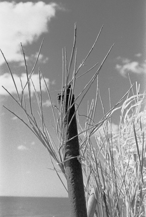

The results are better than I had hoped for being this my first roll. The only problem I noticed is that a couple of frames (number 34 and 35) have a some kind of darker "small ripples" on one side around the "holes" of the film, like the emulsion has been dragged outside the borders (if you know what I mean...). Guess it's a problem with agitation: I followed the instructions of the Paterson thank suggesting to use that stick to twist the reels vigorously in the first seconds of development.
The negatives look a bit grainy (I know this is a characteristic of Rodinal). I have chosen the 1+50 dilution (14 minutes) as suggested by the Rodinal instructions, thinking that maybe it would have been easier than 1+25 for 7 minutes. Is it correct to say that with 1+25 I should have got a bit less grain? Also, would it be correct ot say that if I happened to use a lower E.I. (say, 200 ISO), again the grain might be lower?
I am attaching two sample scans (depicting myself), with no level corrections. Grain has been smoothed by resizing algorithm. I haven't got an enlager, so I cannot post a print scan (one thing at a time :smile:)
Details:
Film: Kodak Tri-X 400 35mm (E.I. 400)
Developer: Rodinal 1+50 (20C) / 14 min. Ag. 30 seconds initial (twist), then 2 inversions every 30sec.
Stop bath: BW-Stop (20C) / 1 min
Fixer:Agefix (1+5) (20C) / 5 min
Wetting agent: Agepon (1+200) / 1 min
Camera: Nikon FG-20
Lens: Nikkor 105/2.5 AIS

Congratulations - Very good results especially for your first roll, mine was errrm crap due to getting finger tied loading the spiral and touching the emulsion.
Tipped the stop-bath away? Never mind I never use it, instead I just use running water for 2 to 3 minutes. Rodinal 1+25 would have reduced the grain slightly but would have also increased the contrast. As your doing your own now try reducing the film speed, I like HP5+ at 200 in Rodinal for example.
My first thoughts on the small ripples and dragged emulsion sounds more like physical damage, did you pull on the roll as you cut the spool off or get a slight jam on the spirals towards the end of loading?
Welcome to the wonderful world of developing and the magical world of Rodinal :wink:

Welcome to the obsession! Looks good for the first time out.
As for those ripples around the sprocket holes, there are a few possibilities
--Physical damage to the film causing an agitation problem as described in one of the previous posts (sounds like a good guess to me).
--A general agitation issue ("bromide drag"), which I've experienced myself with the Paterson reels, but usually it would affect more than two frames. If it's a persistent problem with your choice of developer, film, and agitation method, then try stainless steel reels, and it should go away. It worked for me.
--Fogging through the light trap of the film cartridge. Normally this should be visible not only around the sprockets, but in the frame as well, but since you say you see the problem only at the end of the roll, it's worth considering. If you're changing film outdoors and don't have any shade nearby, then orient yourself so that your body prevents the direct light of the sun from falling on the camera as you load and unload.

The "swirl" marks around sprocket holes are *usually* caused by "cavitation" of the developer, due to too - vigorous agitation.
Unless they extend into the image area, I wouldn't worry too much about them. If they do, I'd slow the agitation down, especially the "twirling".

If those small ripples are dark and kinda crescent shaped they are likely pinch marks where the edge of the film was crimped during handling. Such pressure marks will act the same as if light hit the film in those points and develop black.

Everybody, thanks for the feedback and encouragment. I am really proud of the results myself, it was really fascinating (almost magical) seeing the negatives coming out from the reels with some image on them!
As far as the marks around the holes are concerned, now that you mention it something did happen at the end of the loading, possibly a small jam. Hopefully with some more practice I will become more proficient in loading.
