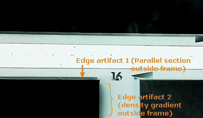

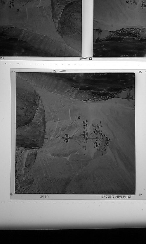

I have run at least 8 rolls of film through my Mamiya C330 MF camera and under certain conditions (perhaps slower shutter speeds, and or over exposed images) I get artifacts outside the square frame area on the negative.
They are different in appearance, probably unrelated. Artifact 1 is a parallel line along each of the two frame edges parallel with the film edge, darker at the top of each frame. Artifact 2 is almost like halation spilling over the top edge of the frame.
I'm attaching two photos showing these. The 2nd attachment with orange text on it is a close-up of the 1st with the contrast increased to better show artifact 2.
IMAG0391_HP5plus_120_image_border_artifacts.jpg IMAG0392_HP5plus_120_image_border_artifacts.jpg

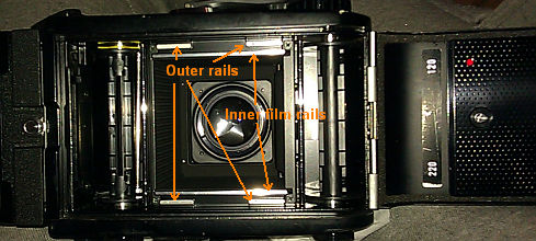

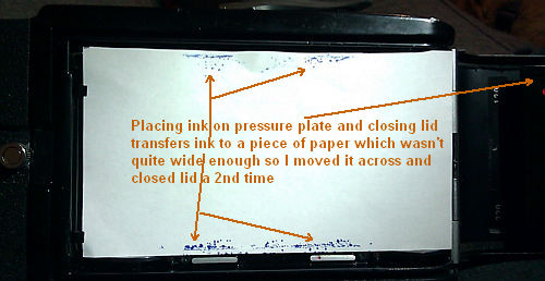

I inspected the pressure plate and it appears to be working OK. Its springs compress about 1.5mm when closing the lid. There appears to be even pressure along the two outer rails. Placing ink on pressure plate and closing lid transfers ink to a piece of paper which wasn't quite wide enough so I moved it across and closed lid a 2nd time.
see photos.

The image opening does not actually touch the film, the film rail does. You are seeing the effects of light get between the image opening of the camera eventually being stopped by the film rail. This is normal for that camera.

This is pretty common, I've seen it before. These are internal reflections of a sort, as ic-racer said, and light piping through the film base. You notice it most in the areas with heavy exposure. Light can travel sideways through the film base, AH dyes or no, if the exposure is heavy enough. I wouldn't worry about it.

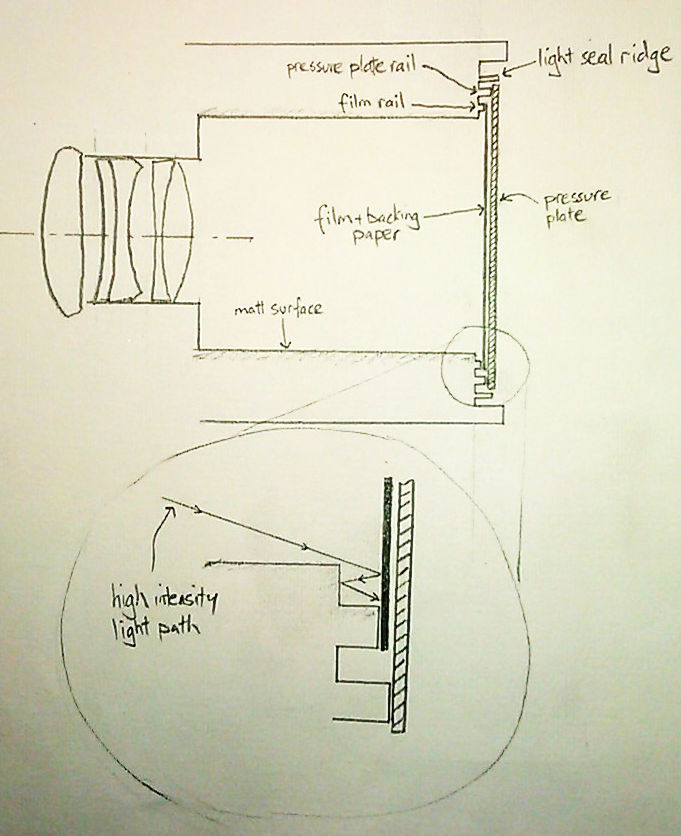

Attached drawing shows how artefact 1 is created outside the film frame
Thanks Gerald, if the lens board was loose the artefact #1 on each side would be diffuse, in fact they are very sharp and well defined. It is possible a light leak is contributing to artefact #2.
erikg, I tend to agree with your analysis about the piping with intense light. That could explain artefact #2.
Graham, no I'm using 120 film. Interestingly the pressure plate doesn't actually press tightly on the film edges, it presses on two parallel rails either side and slightly higher than the film rails - see the diagram below I drew.
I'm now pretty convinced in the explanation(for artefact #1) offered by ic-racer whereby the light reflects off the film surface at the edges and bounces off a recess back onto the film outside the frame area - the picture shows it better.
