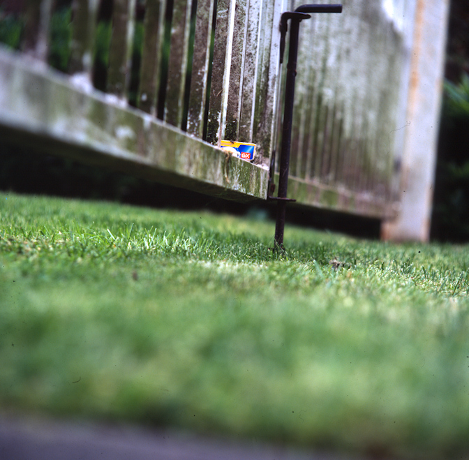

    Before assuming that the rangefinder is out of adjustment, you should try testing it. The easiest way is to use a tripod, some slow film, a tape measure and something like a picket fence.
    Take shots with the camera set to a wide aperture and focused at different distances, marking each time where you are focussing.
    The pickets in the fence will tell you if the camera is actually focussing closer or farther than it otherwise indicates.
    I attach an example test shot.
    The example would have been better if I had more clearly marked the distance (e.g. using a sheet of paper with the distance written on it).
    I find this much easier than focussing on a make-do facsimile for a ground glass at the film plane - especially if you are doing this for a 35mm camera.
