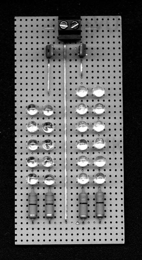

The other - solder your own LED safelight. I added an attachment showing what a friend made for me... three of these banks (Red/660nm and Amber/Yellow/595nm, output is around 5000mcd) plus a mini "flashlight" cost me 15EUR in materials and they give LOTS of light. Two banks light my darkroom of approx 3,5x5m size to a level allowing me to read in there. :smile:
Roman, two quick questions on this light -- first, is it intended to run directly from mains voltage (and if so, do you have 120V or 240V?), and second, can you post a circuit diagram? I can operate a soldering iron (even have one, and some electronic solder, around here somewhere), and the materials to make that kind of light board are cheap (though I'd probably use all red LEDs -- it'll let me use a higher light level and not worry about VC paper).

Donald,
remember, I didn´t make that. ;-)
I hook each of these banks on a switching power supply set to give 12V Output (the "flashlight" is operated with a single 9V block cell) - these cheapo things (<3EUR).
If you want to, I can upload a scan of the backside, just ask here. All you need is to set the LEDs in serial, add the right kind of resistors.
Depending on your LEDs and the Voltage you run them at, you need to choose the resistors. Jochen used a calculator hosted at
http://www.elektronik-kompendium.de/sites/praxis/led-vorwiderstand.htm
, according to his notes it gave: Red: 5LEDs -> 10V 30mA 12V => 68Ohm
I put the banks on the top of two shelves, directed to the ceiling. Thus I get a bright darkroom and it still is safe, even with the Foma papers which usually will get fogged by amber light. Not with these.

Otherwise Roman's idea is great, could you post a pic of the back ??

I´ll scan it later tonight or tomorrow.
Okay, that tells me what I need -- for 12V, it's very simple to use a small power supply and battery (which will also keep my darkroom lit for a while if the power goes out, which it does here from time to time), and I should be able to get enough current from a single supply to run several of these arrays. Calculating the correct resistor is easy enough, just need to know the voltage drop and desired current of the diodes (which varies depending on the diode you get, of course). I think I can get/make a few of these arrays and get a small 12V gel cell battery for considerably less than buying a darkroom safelight, which is a Good Thing...
