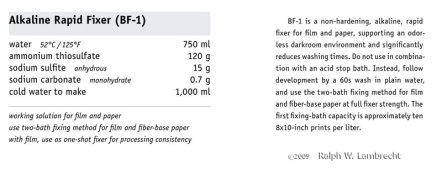

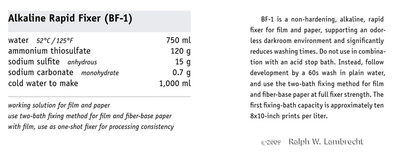

Talk to them. Their MSDS sheet does not identify the chemicals their fixer contains (???). That's unusual. Alkaline fixers should not smell. None of the ones I know, do. Kodak F-6 is almost odorless. The 'Darkroom Cookbook' lists odorless formulae. According to that book, the odor is caused by sulfur dioxide. The substitution of balanced alkali or sodium carbonate for boric acid eliminates the odor. Attached is my own formula.
