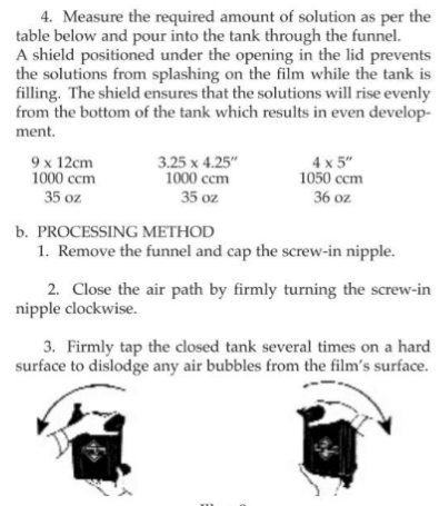

Hi again, it's me haha. So I've had the Combi Plan 4 x 5 Daylight tank for years and have not used it yet. Hasselblad shooter as I have been all the time.
Now, the thing is that C41 chemicals for 1 litre is most affordable....but this Combi Plan says it needs 1,050ml (sorry, but I'm European!). That being said I put in 1000ml of water and I found the film would be submerged. My question is....can I get away with using 1000ml only????
I also have the MOD54 film holder for use with Paterson tanks which immediately solves 'the problem' but more often than not I get liquid spilling from the lid in my inversions and its really really really annoying......
What say you my friends....?

oh now I see now its 1050 ml.....the actual product said 1,200ml on its plastic......so 50ml is what I am asking about

I hadn't looked at the HP Combiplan user instructions in decades (I purchased one three decades ago, but never used it, so sold it) , and I recently consulted a PDF copy available on the web. The user manual is very explicit in its statement that 1000ml/35 fl.oz. is needed for 3-1/4 x 4-1/4 and smaller sheetfilm, and 1050ml / 36 fl.oz. is needed for 4x5 sheet film. https://www.galerie-photo.com/manuels/HP-Combi-Plan-T.pdf
That three users all confirm 1000ml works fine is beneficial to peace of mind...I wonder why the manufacturer stated 50ml more was needed, perhaps to lessen possibility of issues arising?!
