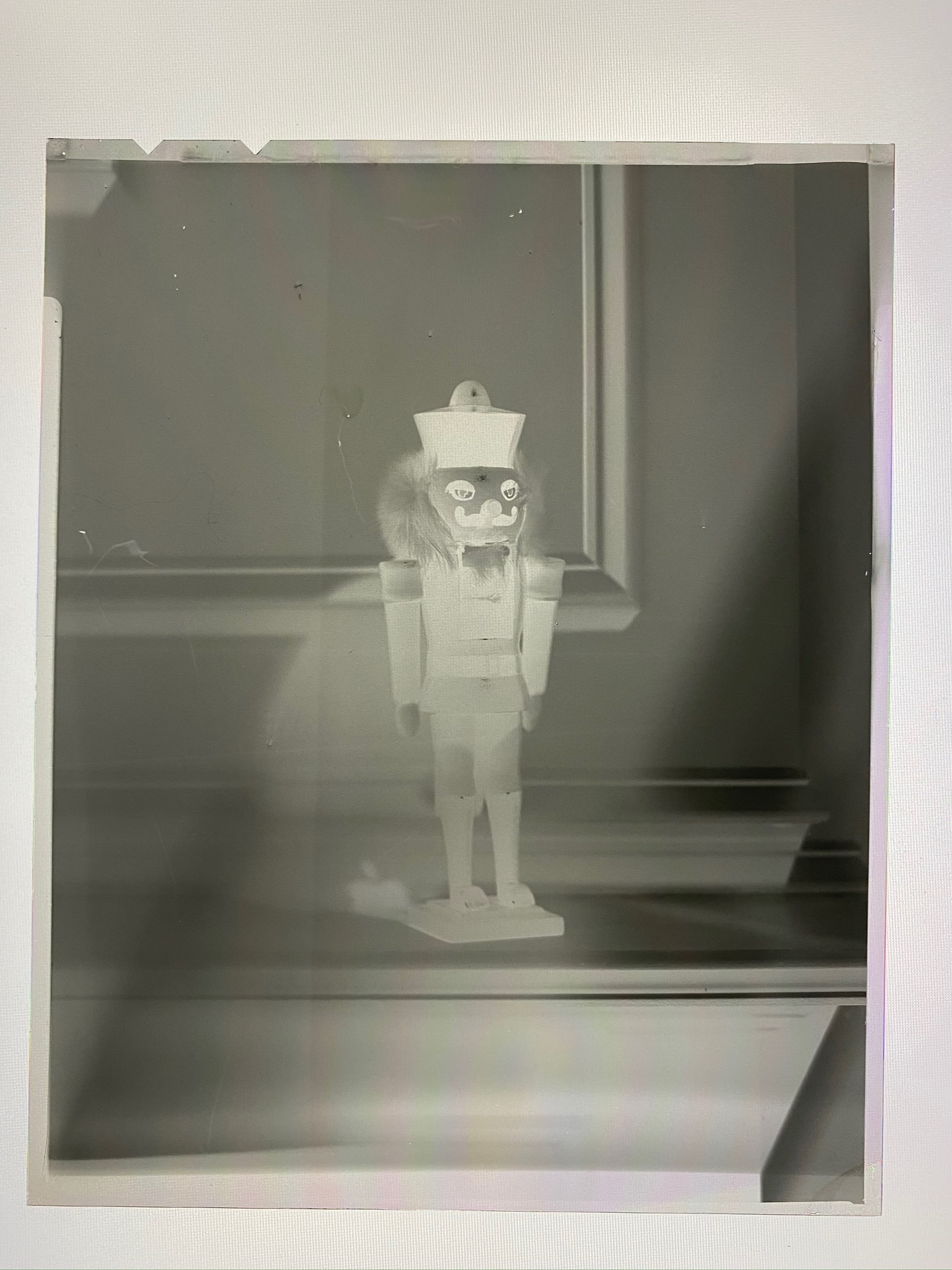

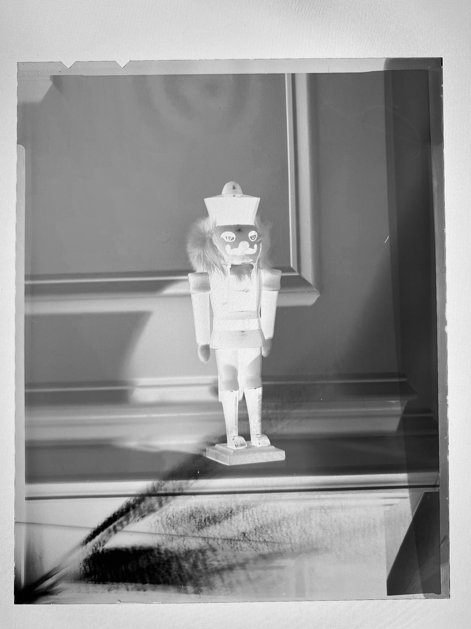

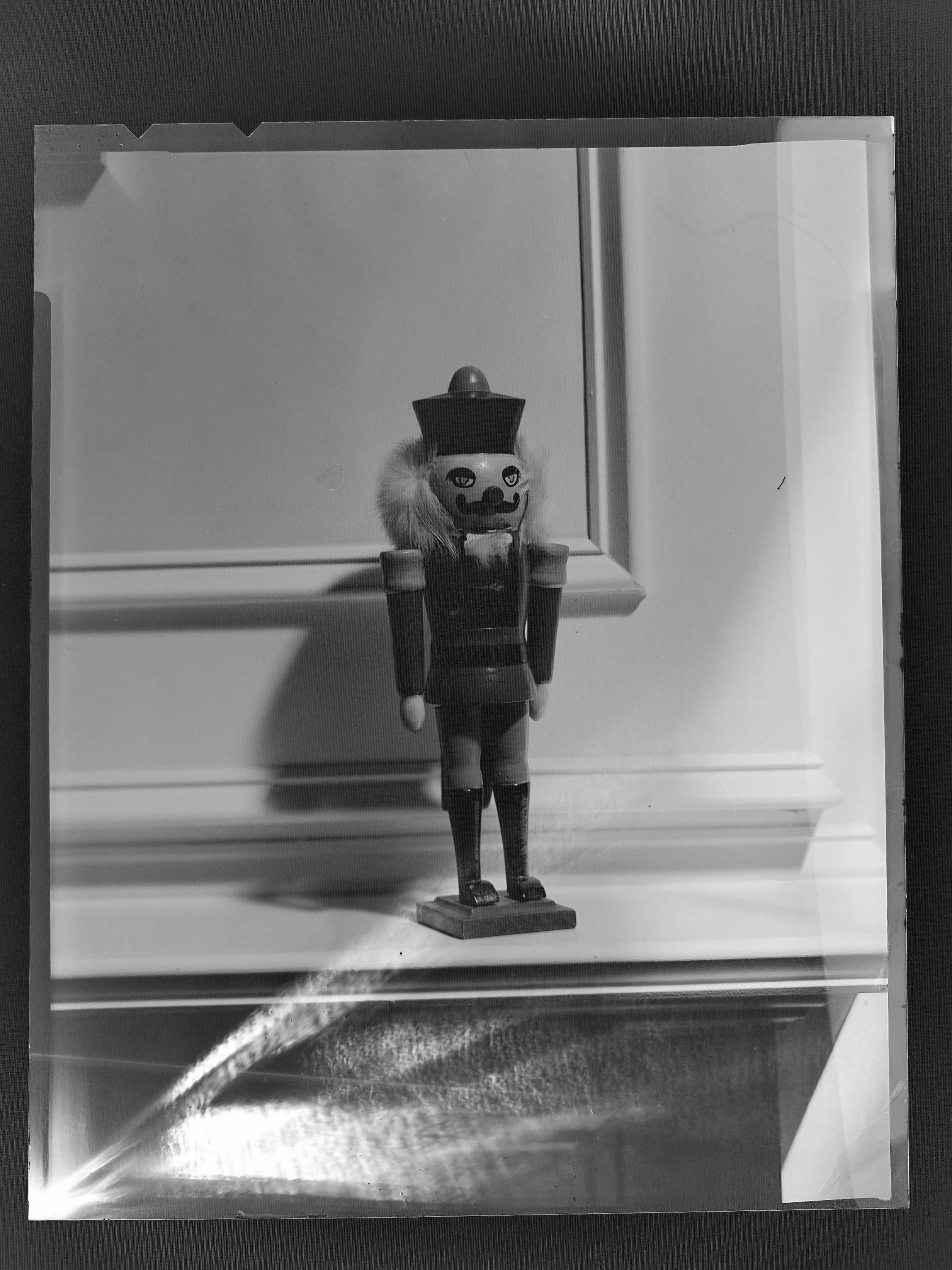

Never mind the light leak and banding (beginner's errors!) TMax 100 (exp. 1991, rated at 100), "taco" developed in Rodinal 1:100, 15 minutes. First LF "portrait" taken with Omega View 45, Fujinon 210mm lens, f8 @ 1/60th. "Scanned" with iPhone 11 and processed in Photoshop. No sharpening applied. I know it's crappy, but I'm excited nonetheless. I'll post the negative image later.
It's a start! Many spring back cameras more or less require you to hold the film holder against the camera back as you extract the dark slide; that goes double if you have Graflex film holders on a Graphic back (or the other way around, I can never remember which has the rib on the holder and which on the camera back).

Thanks Donald, I’ll keep that in mind. I made a second exposure (underexposed) that did not have the light leak. I have an idea of the cause, but can’t confirm it. The band on the right was from overlap of the second negative. The rubber bands I secured them with for taco processing fell off, and each negative stuck to the side of the tank! Think I’ll try trays next time.
The exposures were made in haste, as I tend to do things “spur of the moment.” There was a nice pattern of light from the room’s transom windows that was moving rather fast because of the sun angle, and I really wanted to capture it. I’ll try again this weekend when I can set up the shot more carefully and wait for the light. I’m just happy the film is usable, though I may rate it at ISO 50.

It does look rather underexposed. Did you account for the bellows factor? It's pretty significant (I estimate 1-2 stops) at this close distance.

In my haste, I did not adjust for the bellows factor. I will next time, though! Upon reflection, I'm sure the light leak is due to poor technique when removing the dark slide. The second exposure had no leak, but it was really underexposed, as I turned the aperture dial the wrong way. Typical rookie stuff, I guess.

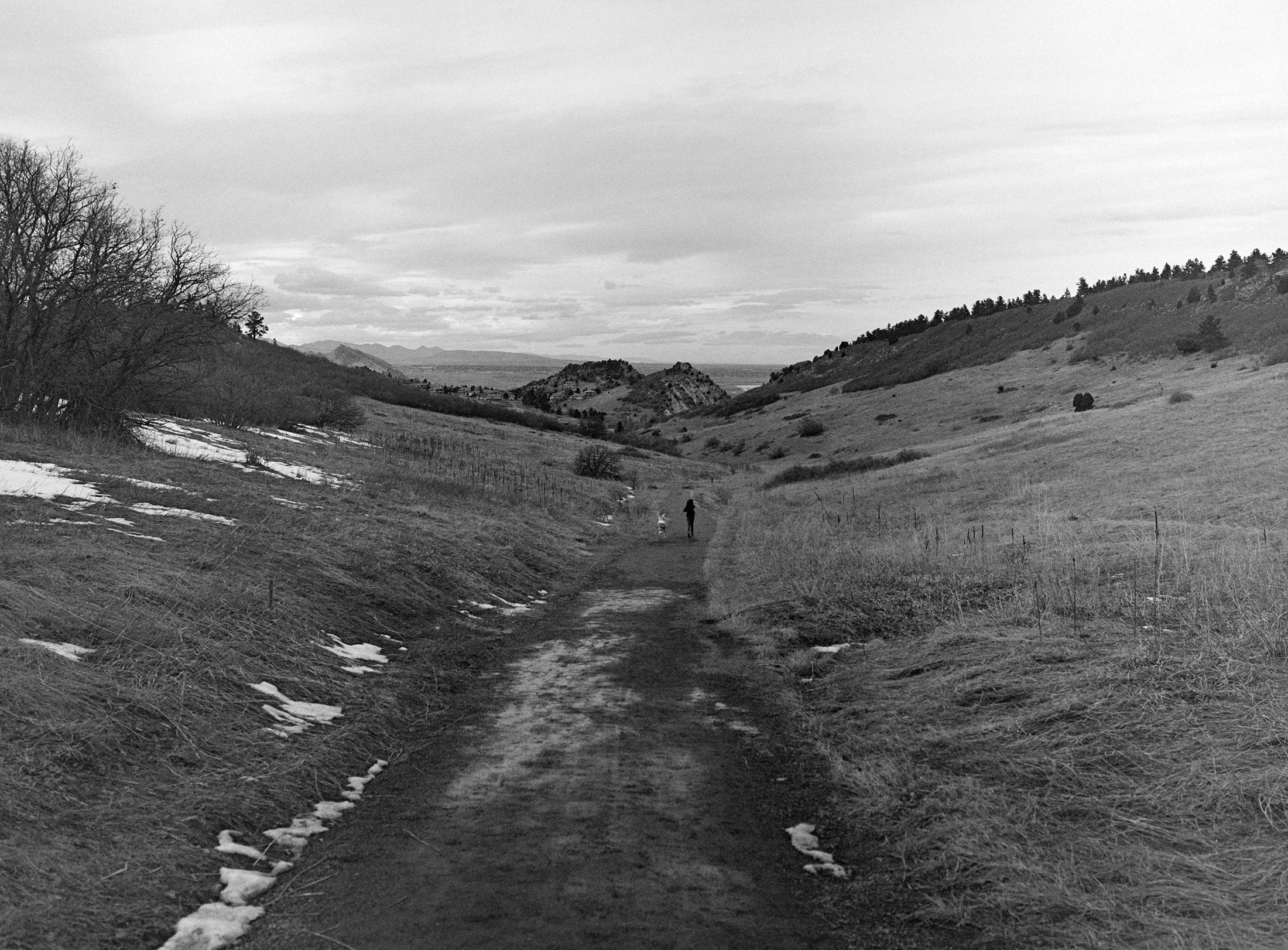

Attached is some 6x4.5 Kodak Plus-X (125 ASA) expired in 1962, shot at box speed and processed in my custom developer EXG1 (gives rodinal-like grain levels). There is a small amount of base fog, but honestly surprised how well it held up and that box speed processing actually gives good results. I suspect it was kept cold in a fridge, but not frozen since purchased. I got it from an estate sale with a ton of other film in similar condition. I have like 17 more rolls of this to shoot through.

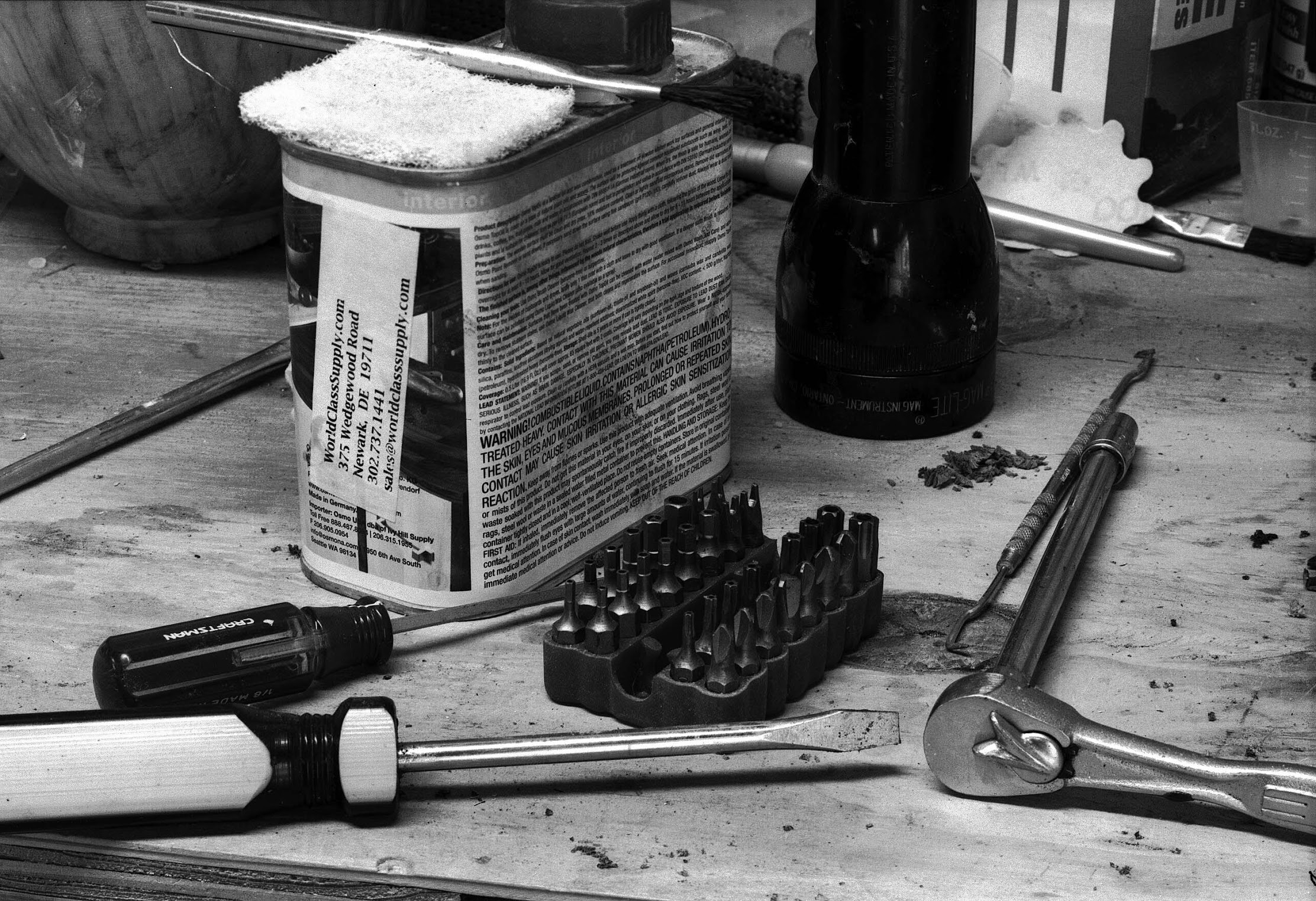

This 48 year old Efke R27 worked quite well at ei 32 and processed in Rodinal. Interesting to note the poor red sensitivity of the film, the flashlight was dark red and the bit holder bright red.
