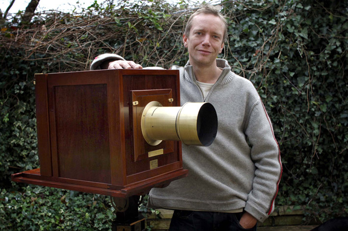

Here's the camera and lens:
For those that are interested there are many more pics from the camera on
my site , www.nospin.co.uk.
Best to all,

She's a beaut'. The woodwork looks first-rate and that's a heck of a brass cannon hanging on it.
