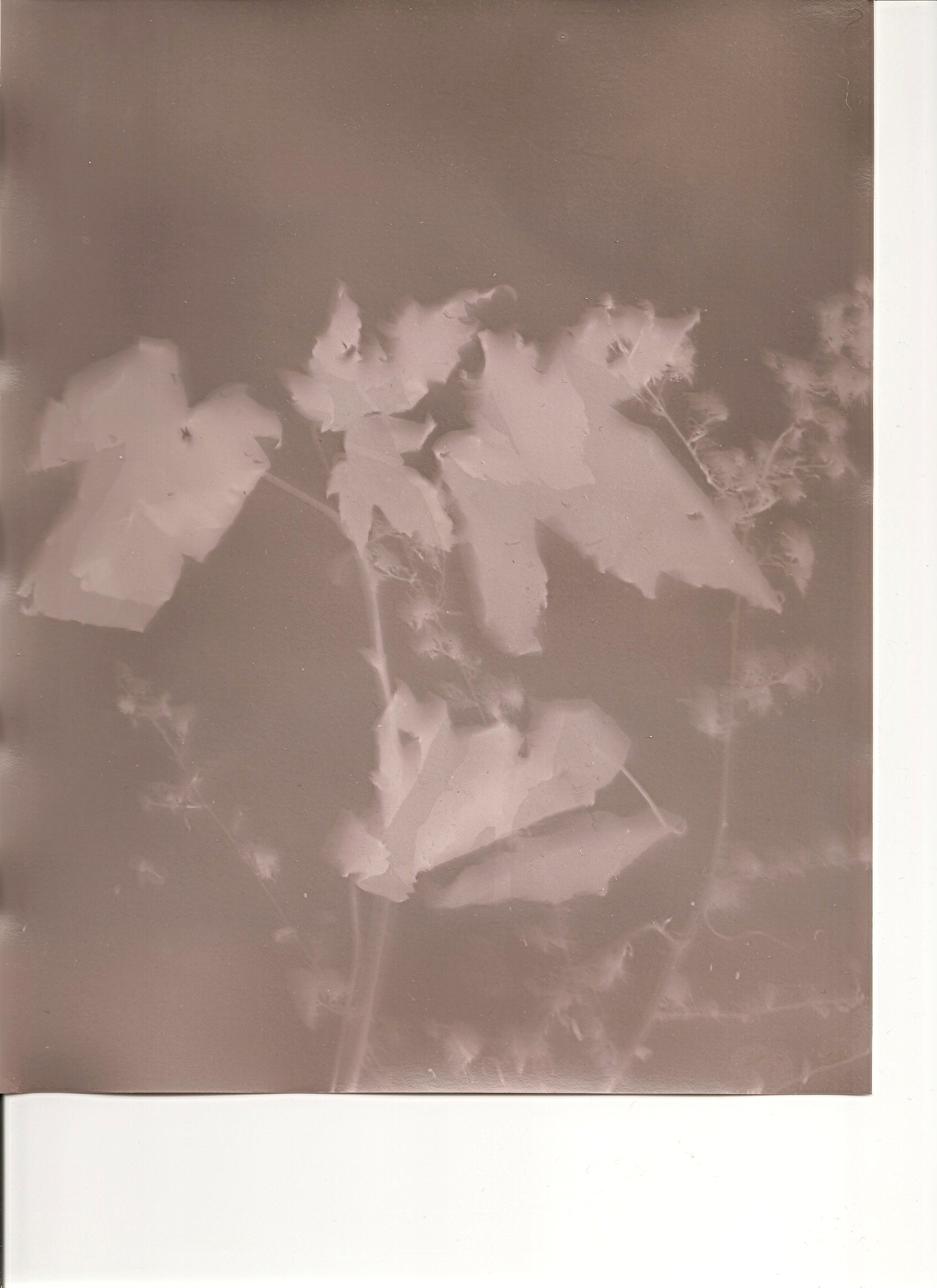

  10. OP
    guitstik
    guitstik Member
    Messages:
    1,097
    Joined:
    Jun 19, 2010
    Location:
    Eads TN.
    Shooter:
    This is what I have so far.

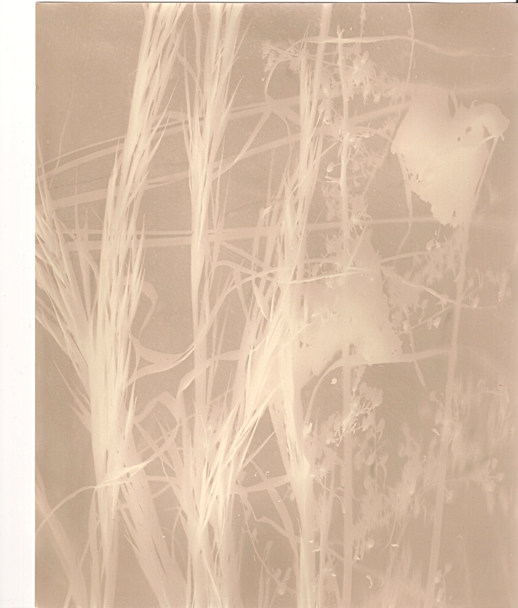

  12. OP
    guitstik
    guitstik Member
    Messages:
    1,097
    Joined:
    Jun 19, 2010
    Location:
    Eads TN.
    Shooter:
    These are my latest attempts using the same Oriental Seagull VC paper from the first two attempts. This time tho, I left them out for about 4 hours and fixed for 45min. Dann, I think that you are correct, I do need to use an electric source as the winter sun might not be producing enough UV light.

  13. bsdunek
    bsdunek Subscriber
    Messages:
    1,486
    Joined:
    Jul 27, 2006
    Location:
    Michigan
    Shooter:
    Much better. I don't understand the long fixing time though. I fix the same as for any print and have had no problems. Two minutes for RC papers works for me.
    Unless you have a cloudless day, lumen prints will probably take quite a while, but two to four hours is about right in my experience.
    If you use artificial light, you will need UV lights to get the same effect - sort of like making cyanotypes, salt prints, etc.
    Have fun and Merry Christmas.
  14. OP
    guitstik
    guitstik Member
    Messages:
    1,097
    Joined:
    Jun 19, 2010
    Location:
    Eads TN.
    Shooter:
    As for the long fix time. I was using not quite exhausted fixer and I wanted to see if they would get darker with a longer fix time. The last one is the first one to get fixed the other two received a water bath before fixing to see if that affected the end result.
