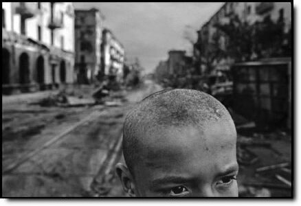

This example is from that movie. Other photos also, but this one most.

Here are the top 5....
5. Expose enough, but not too much. A deep, pure black gives us shadow accents that help us perceive depth in the 2 D pictures.
4. Develop enough, but not too much. Local contrast sets detail against detail, necessary to the illusion.
3. Use light to separate form and mass. We're photographing the light, aren't we ?
2. Use contrasting tones to make the picture. Nachtwey is drawn to scenes that reveal themselves.
1. Learn to see.

The example photograph has a 3 dimensional appearance because, among other things:
1) There is a clear foreground, and an obvious background, and they are well differentiated;
2) The foreground subject is both 3 dimensional, and of a shape that is known to be 3 dimensional, so we recognize it as such. In comparison, the background is somewhat 2 dimensional;
3) The tones and micro-contrast in the foreground are distinctive and attractive. The background is blurred, has more macro-contrast than micro-contrast, and generally is of a different tone, so the foreground and background are strongly differentiated.

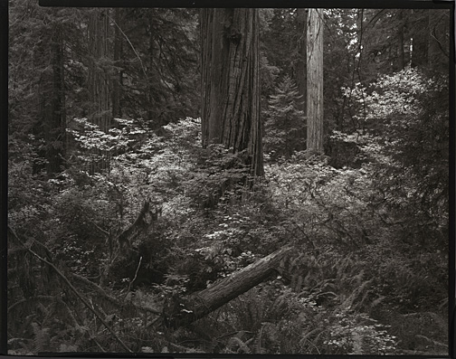

Here is a scan of a carbon print -- you can't see the raised relief, but the image itself seems to have depth to it -- all is in focus, "normal" lens for the format (300mm on 8x10).
It seems to cover the points df mentioned, and the first point (and perhaps the second) the Matt mentioned.
