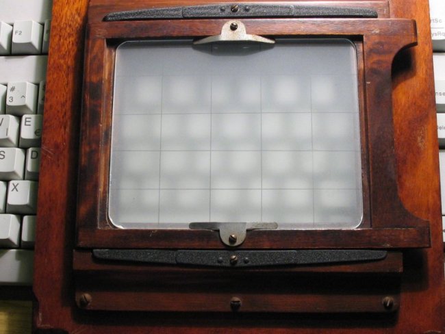

Homemade GG
I'm rather late here, but I just wanted to add my experience in making my own GG.
Although I'd much prefer to have Dave's ("SatinSnow") ground glass, the complications implied in sending it across the ocean are not worth it.
In short, today I made 2 (two) pieces of 4x5 GG in about 5 minutes - no aggressive chemicals involved!
It's a variation of Dick Dokas' method listed earlier.
In short: you need a piece of thicker glass to be used as base, some valve grinding compound, a few drops of water, and about 5 minutes of circular motion ("elbow grease").
You might experiment with various grades of "grinding paste" (i.e. valve grinding compound) first, using smaller pieces of glass, to see which grade suits you best.
The thickness of glass usually isn't that important - at least for the cameras I use. I used 1,8 - 2mm glass from a glass shop, where they cut it to my specifications - I'm not very successful in cutting glass :sad:
Anyway, it takes about $2 for the glass (already cut), $3-$5 for the "grinding paste" (that's what the product is called here), and about 5 minutes of work.
You might inspect the glass every now and then (rinse it in water to wash off the paste and dirt, and then dry it) to see if the sanding is even.
The two attached photos show the end result - the photo with two glasses on the keyboard shows my DIY GG on the left, and the "original" on the right. The "original" also looks like a DIY job (it came with the camera I got recently), but the grain is quite coarse - probably done by sandblasting (which is almost unusable for this purpose).
The grid was done with a pencil :smile:
