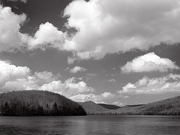

stradibarrius, in short, filters lighten their own color and darken their opposite or complimentary color. For example, a red filter will lighten red objects and darken cyan (blue) objects. Yellow will lighten yellow and darken blue. Green will lighten green and darken magenta (red). But it's not so straight forward either, Red won't just lighten red objects, but will lighten orange, pink, and some yellow objects as well as these colors are close to red. I have a yellow, orange, red, and green filter, and use the orange far more than the others. To me yellow is a bit too subtle and red it a bit over the top, though I do use them for certain things, I'm talking about shooting landscapes, skies, clouds, etc. You have a good set of filters there. I'd certainly add a polarizer, and maybe even green. Alot of times when shooting deep blue skies with clouds I'll stack an orange filter with a polarizer, this is a nice blend for separating clouds from the sky. I've attached an example. The green filter is great in spring time with lots of foliage, it lightens things up. Green is also nice to darken down red or orange objects, such as barns. The best way to learn is to simply shoot the same scene without the filter, then add each one, and bracket your exposures as well, then when you look at the contact sheet you'll be able to make appropriate determination on filter factor, and you can also see the effects of each filter.
