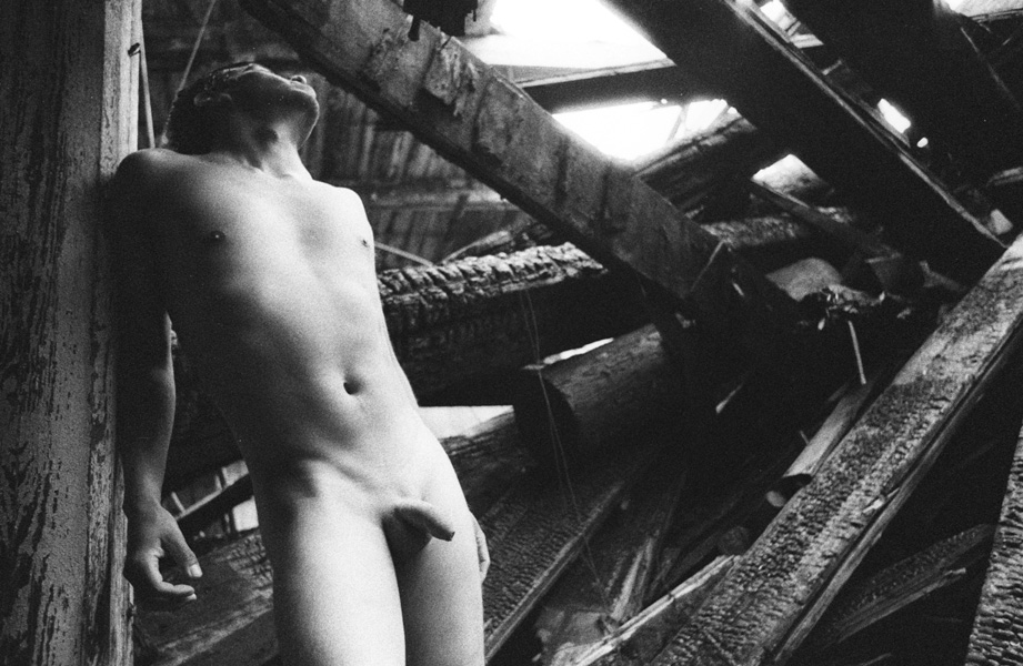

It worked out
Thanks for all the help, guys, I developed it with Sprint (the store ran out of DD-X) diluted 2:8 for 11 mins 15 sec at 73 degreesF It turned out rather well.
