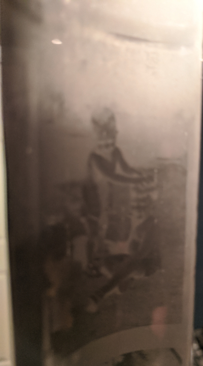

Okay, the attempt has been made.
With success i'd be proud of if this were in fact Mallory's Everest camera and film! It's not; it looks (from the negatives) like either a kid's outdoor birthday party or a Cub Scout expedition, but there are seven clear, sharp, obviously printable/scannable images (the eighth frame is blank except for a halo that probably represents decades of light exposure through the red window). I'll have better images in a few days, but here's one where I had my cell phone much too close to the hanging strip, backlit by the overhead light in my darkroom with scatter from the very reasonable amount of fog.
I don't think this is a bad result for film that has to have sat in the camera since before I was born (and that's a bigger statement than it would be for a lot of the YouTube "I developed film from the 1980s!" crowd).
After leaving the bottles in the coldest spot in the house for several hours, I found the developer at 16 C (62 F), calculated my time at 23:30 with temperature compensation (confirmed for me by the temp compensation function in the Dev-It app I use on my Android phone). I inspected under red safelight at 12:00, decided at that time to inspect again at 18:00, and at 18:00 decided to stop development at 20:00. Standard acid stop, Kodak Rapid Fixer, Ilford wash, and C-41 Final Rinse (as that's the wetting agent I have mixed up), and the film is hanging to dry now. Despite the poor focus by the cell phone camera, the negatives look pretty sharp to my built-in magnification (-6.75 nearsighted prescription) -- probably about as good as one can expect from an achromat meniscus.
This is also the least exposed of the seven frames, so I'm looking forward to getting these scanned -- not to mention processing the new Rerapan I shot in this AVPK after I received it.
Looks good - hard to imagine it could look better, actually. Great job!
