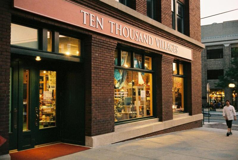

htmlguru4242 said:
Dmr, how good does it look under tungsten, is there a noticeable tint to it?
I tried to find a good example of this that I know was 1600 under only tungsten, but I don't see any that I have handy. I hope these examples will answer for you.
Yes, if you don't do any correction on it, it will show a warm tint. However, when I scan it, some simple level adjustments make it look quite normal (although I prefer indoor incandescent shots to have a bit of a warm tone to them).
Anyway, the one on the left below was taken after sunset, and the outside light was only twilight and afterglow plus some street lights. I know it looks brighter than that, but that's the way it was. The inside of the shop is obviously incandescent.

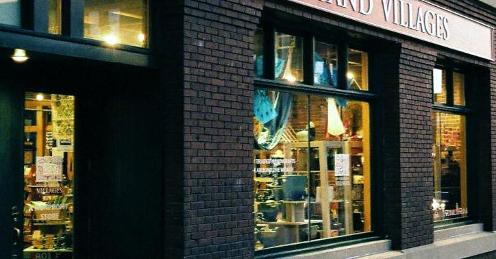

The second one below is a crop of the window area with simple level adjustments. The inside of the shop now looks quite normal to me on my monitor. I know this is not very accurate, but ...
This was just boosting the blue a bit with the high end slider and tweaking the red center slider to balance it out.
I hope this helps, and sorry I don't have any better examples close at hand. :smile:

dmr. Only you know what colour the brickwork outside the shop was and how it looked at that time of night. It looks as if the second pic is more accurate if you consider the brick to have an intrinsic natural colour but for a twilight tungsten lit scene the first looks more natural IMHO.
pentaxuser
