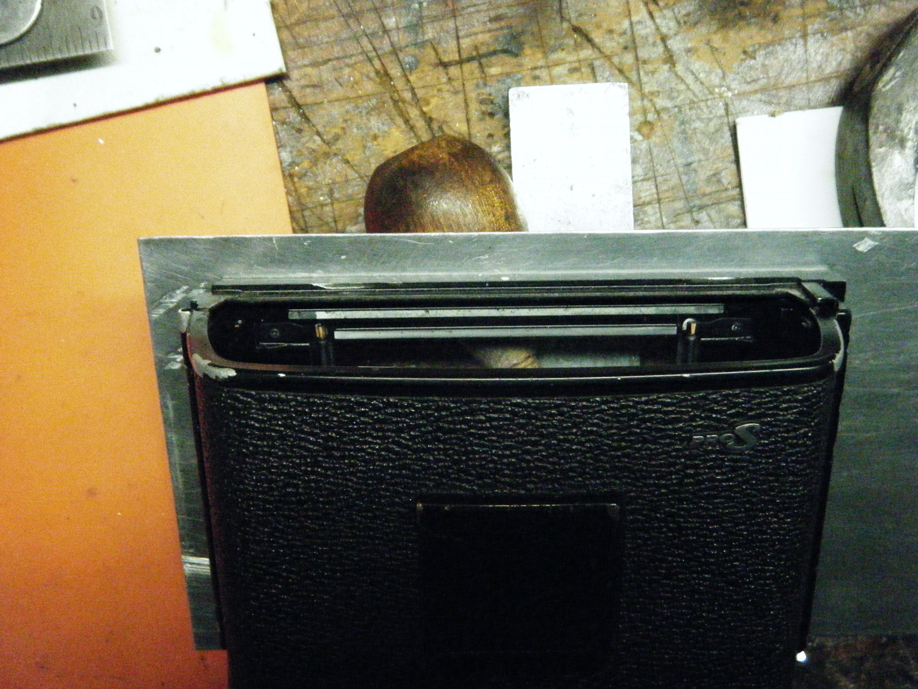

    i built a roll film back using an rb67 back and a plate of aluminum. i have to figure out how to compensate for the back focus now.

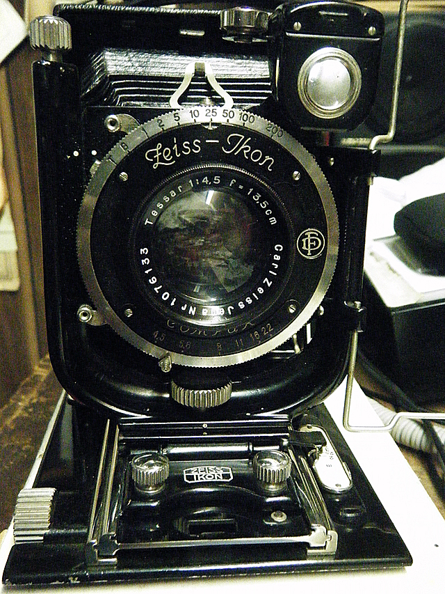

    hahaha I have no idea what any of that means... maybe you can tell by these pictures what the difference is? It says 207/5 right under the top strap and is definitely a 9x12.
    DSCF6225.JPG DSCF6223.JPG .
  8. OP
    paul ron
    paul ron Member
    Messages:
    2,677
    Joined:
    Jan 22, 2004
    Location:
    NYC
    Shooter:
    ooooh i see what you're talking about re the shift... its a knob n manual slide shift on mine... ah ha ok.

    I made a roll film back using an RB67 fillm back. Mounted it on an aluminum plate with the film gate cut out... screwed it directly to the plate. Its a bit back focused though.. but very usable.

    RB film back mounted on a plate to fit the Maximar

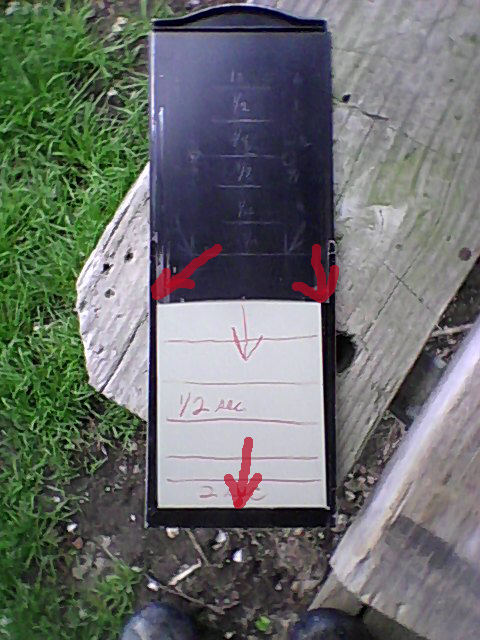

    how I fit my 9x12 film into a AVUS 3.25"x4.25" film holder.
