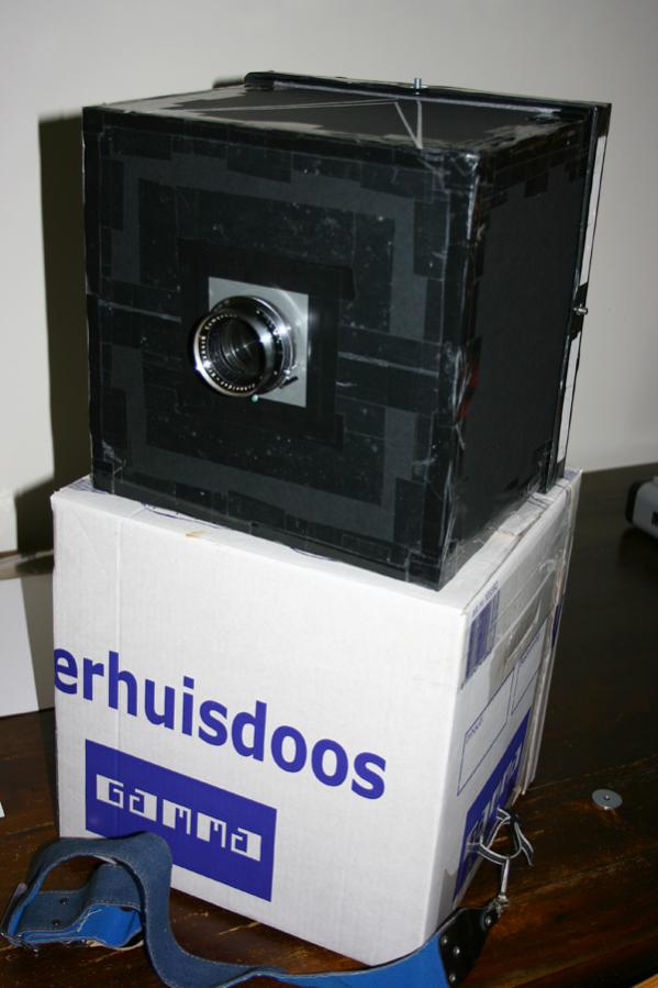

    yeah i was most surprised when it actually covered 10x8 at infinity, i will post a picture of my camera at some point for you to look at.
    no ground glass just exterior site lines, calumet lens board was used with compur and elements screwed directly to shutter
    the lens board is press fit in a rebated opening in the camera and then black tape sealed, the camera has been light tested with paper for 4 hours with no noticable fogging

    the box is a kinda fair weather tripod, going to be used for ALT process
