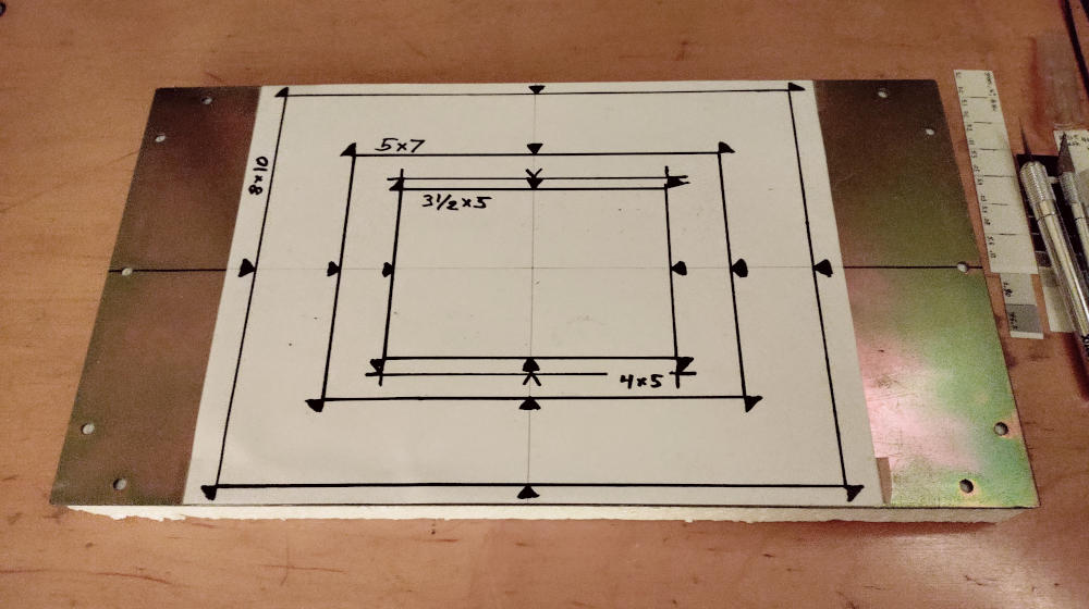

I know this thread is ancient, but I figured I'd show off my home-made easel:
It's a steel panel that covered an electrical box. I found it in a trash bin at a demolition site. The sheet of foam under it makes it easy to grip and prevents it from scratching the baseboard.
I recommend using plate steel (not aluminum) because you can hold down the corners of the paper with hobby magnets.
You can buy new plate steel in a variety of sizes from industrial-supply companies, as in this example which is suitable for 11x14 and smaller: Low Carbon Steel Sheet
I recommend using plate steel like this because you can hold down the corners of the paper with hobby magnets.
Well done!

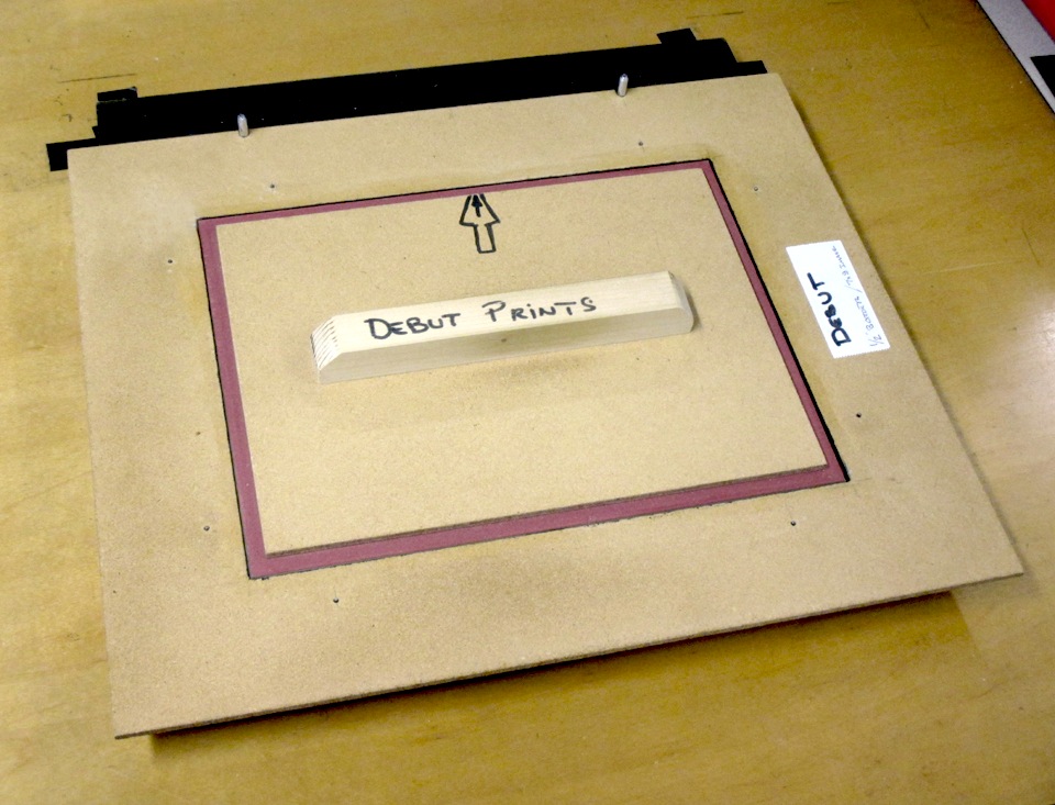

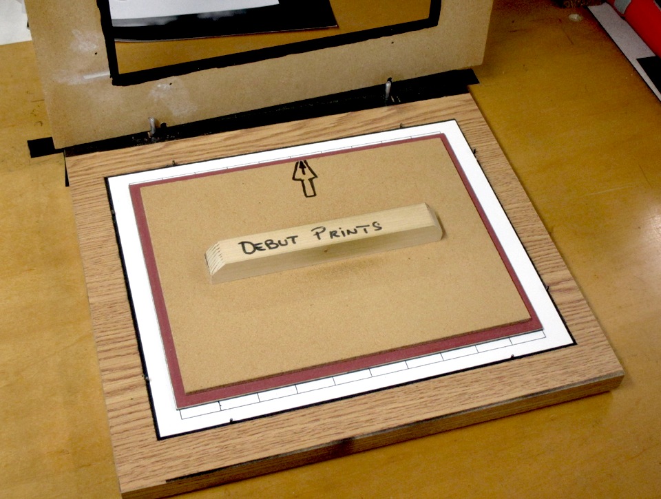

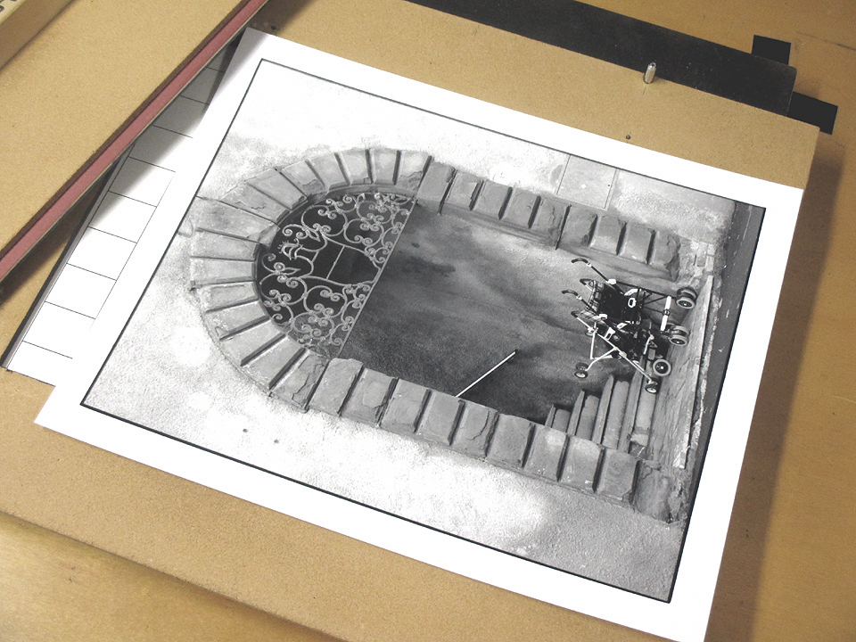

As Pieter12 described, I've been using standardized easels for years.
I posted a "How To Make a Dedicated Easel" over at FADU (Egland) a few years ago...
Reinhold
So simple! Thanks, Pieter!
