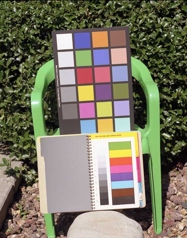

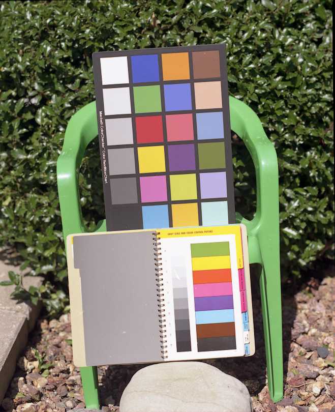

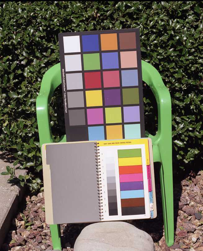

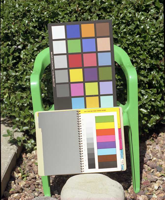

Here is Portra 160 in 120 size, shot in an RZ67.
All were on the same roll and were exposed as indicated, 160, 100, 50, 25 and as a bonus, 200.
PE
