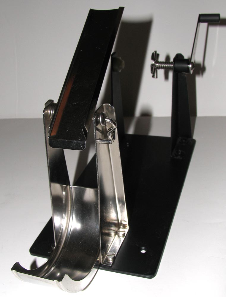

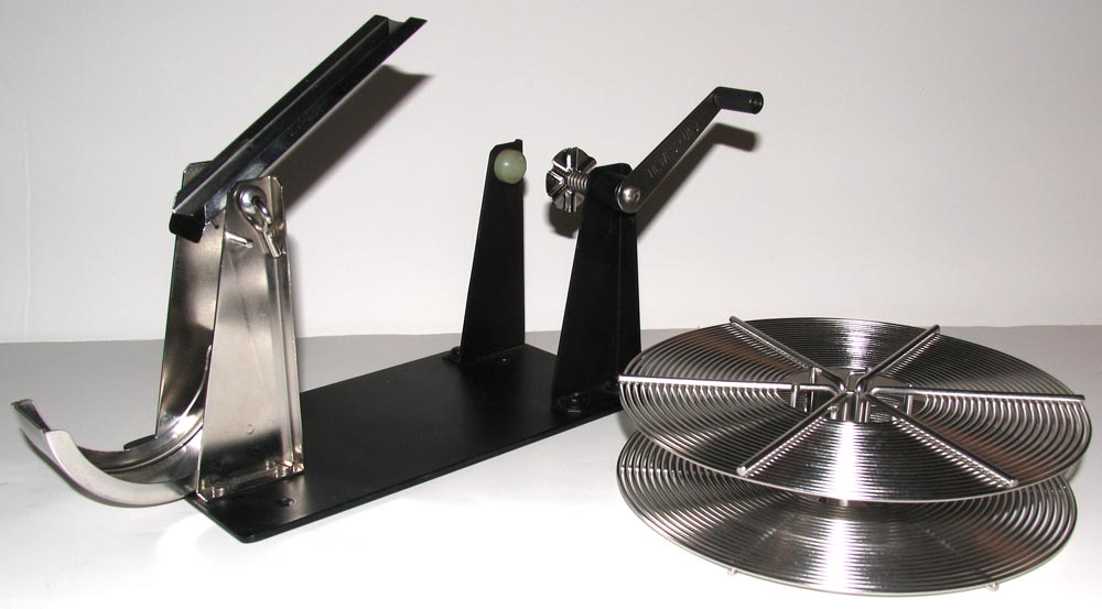

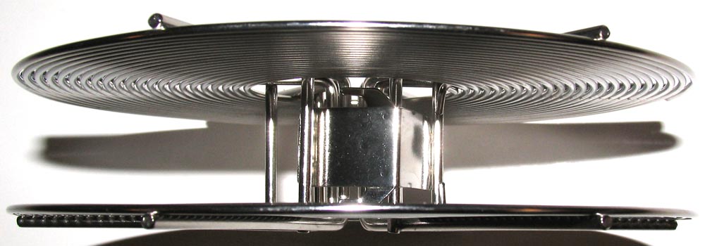

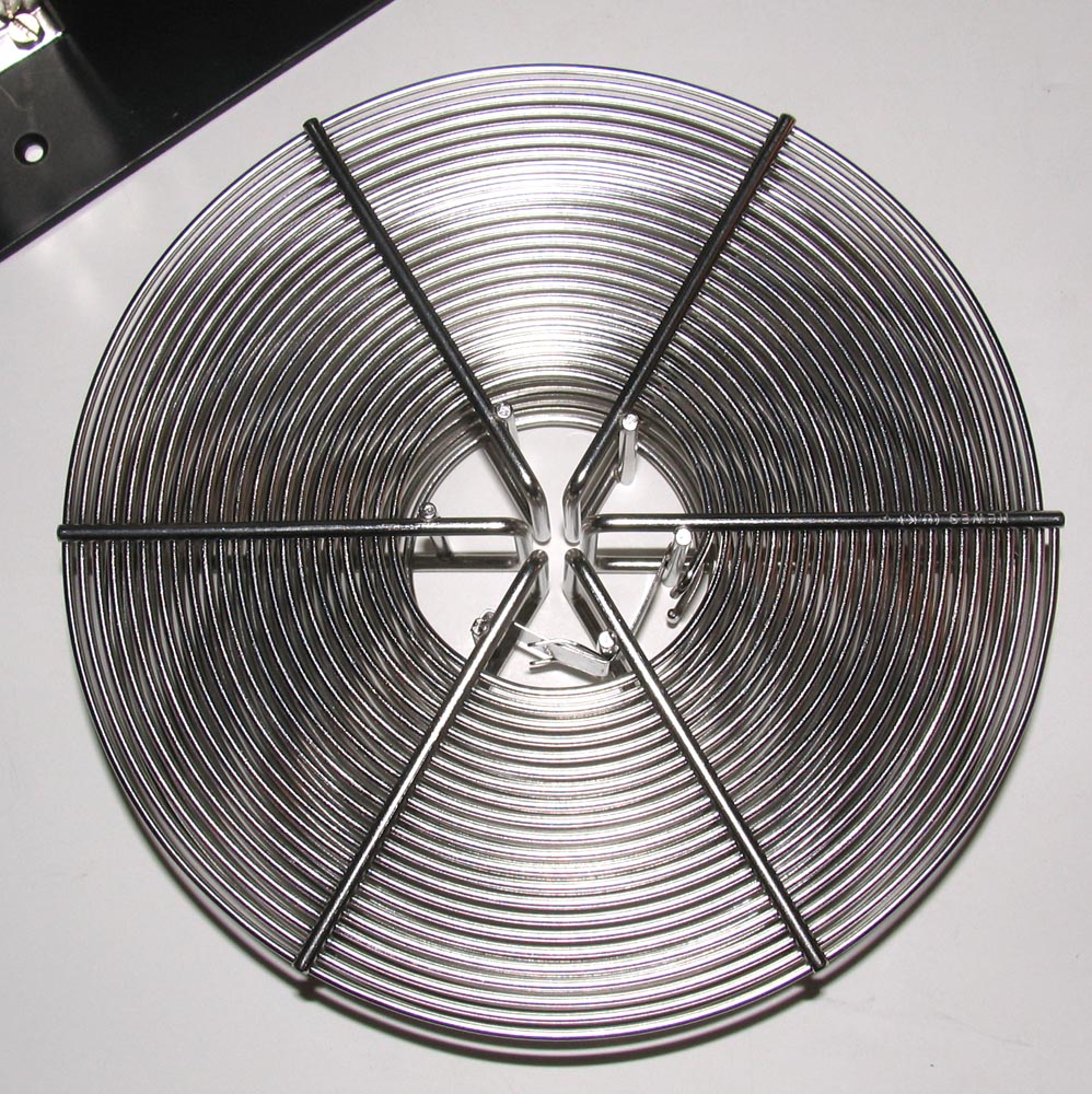

Since I've got the Canon 100-exposure back for my F-1, I'm always looking for better equipment to process the film. Recently I've been using the Jobo tank and reel and just doing it by hand since I don't have a processor. But lo and behold, Hewes makes a giant stainless 35mm reel, and a loader for it! I still need to come up with a tank for it, but I'm really excited to be able to use a glorious Hewes reel (complete with their little sprocket tabs) for my long film. How come nobody knows this exists?
I couldn't find anyone who sells it so I emailed Hewes and they worked with me to procure one.
Pics below...

Nice! What's the diameter of the reel? Nikor used to make a 220 reel with the same wire as a 120 reel that fit in a larger tank, and I'm fairly sure the Nikor 4x5" sheet film tank is the same size as the 220, so it's possible that it could fit that tank. Otherwise, it might be best to use something like a set of 5-quart rectangular tanks for 5x7" sheet film and a lift rod, or I suppose you could even use print trays.

The Hewes reel is just a hair under 7" diameter. The Nikor large tank (for 4x5 and giant-size 35mm, 120 and 220) is 4.5" diameter.
I've got a Nikor 70mm tank coming that I think it will fit in nicely (supposedly about 7.5" diameter) but sadly it's not a daylight tank - just the old style tank and lid setup.

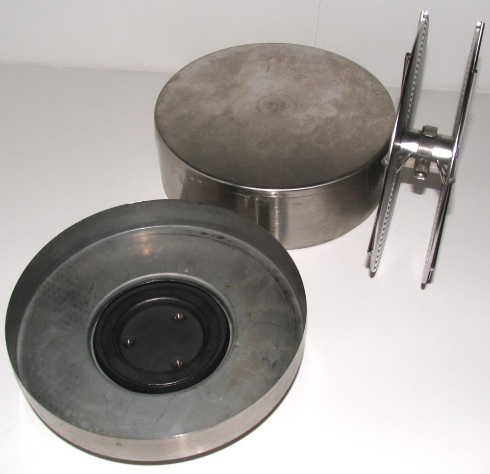

Drat - the small 70mm Nikor tank just misses being big enough for the Hewes reel (see pic). The search for a tank continues.

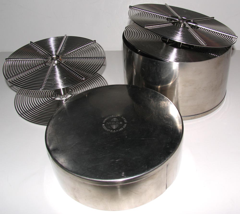

I do also have the massive Nikor 3-nesting-tanks-with agitator-lid set but haven't picked up a 35mm reel for it yet. Just have the 16mm and what was purported to be 70mm but measures more like 120 (which would be weird to have that much length of 120 width film!) plus the loader.

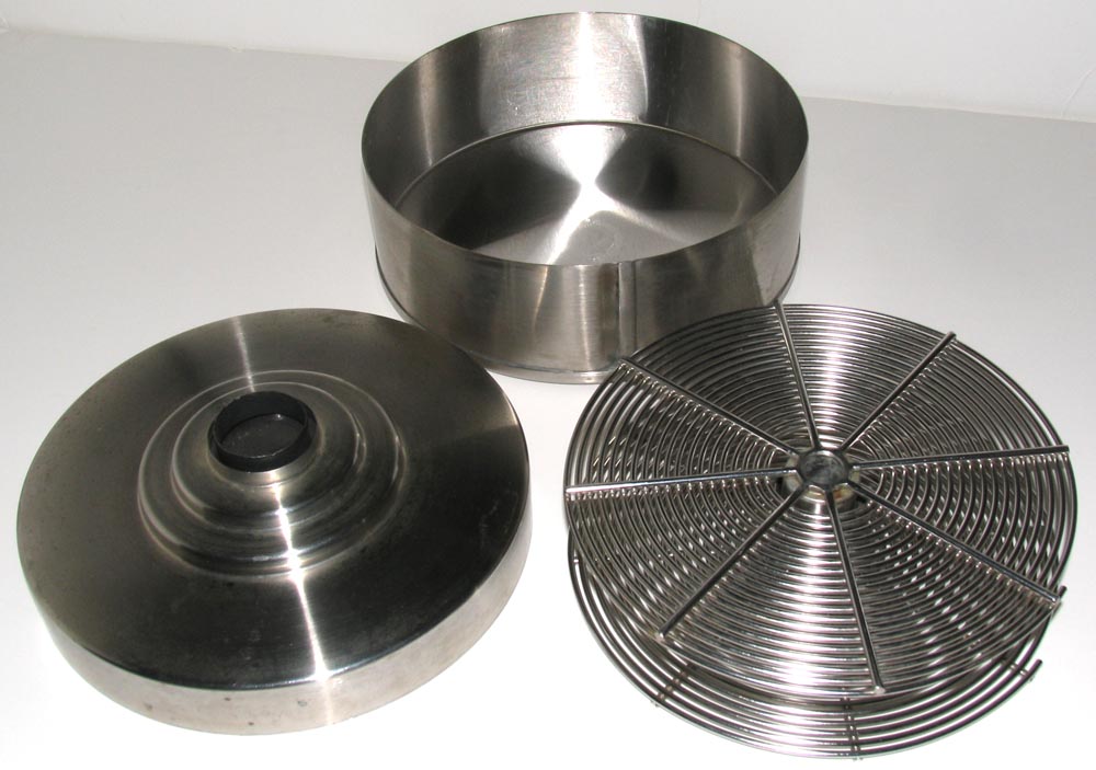

I use a set of three Nikor tanks for processing the long rolls of 35mm film from my Canon 100 frame back. The inside diameter of the Nikor tanks I have are 6 7/8 inches. I dry the film on the roll in a small film drying cabinet with air blowing gently through the bottom of the reel. Some of the Nikor reels have an agitator that goes in the center of the reel to allow the film to be moved up and down in the solution for agitation. Nikor did not recommend rotating the reel very much as it would cause the outer edge of the film to develop at a different rate than at the center.
Nikor also made larger reels for 28', 50' and 100' of film that were 10" to 17" in diameter.

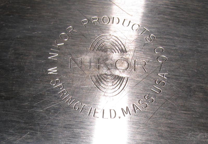

When you said you had a set of 3 tanks, I was picturing the standard Nikor long-roll nesting tanks with one lid - they aren't daylight tanks, in that you need the lights off when you transfer the lid/reel from one tank to the next. But now I've come across this Nikor rig and wonder if that's what you meant instead. It's a hair under 7", and 100 exposures fits perfectly on the reel. I got two of these tanks and just one lid, and sadly the lid fits neither tank :-(
