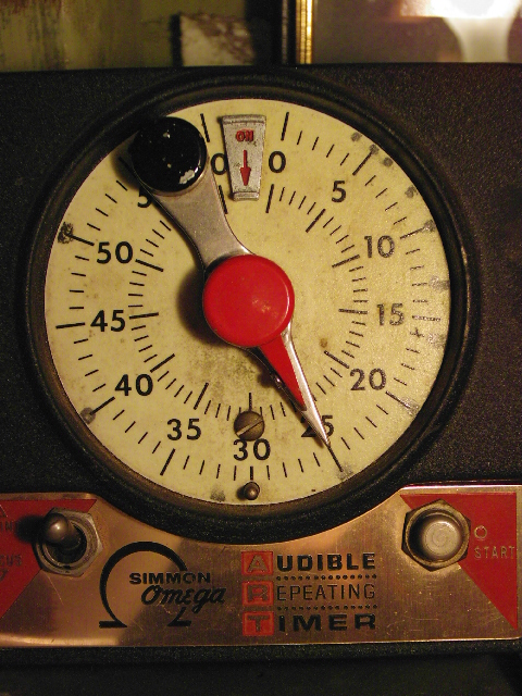

How to turn Time-O-Lite Timer into an f/stop timer
I use an Omega-branded model and turned it into an f/stop timer...
Each dot is 1/3 stop... In use I memorize the seconds between dots. In this example, 5, 4, 3, 3, 2. During exposure, I wait until I hear it clicking and then I do test strip series or burns and dodges in terms of the memorized clicks.

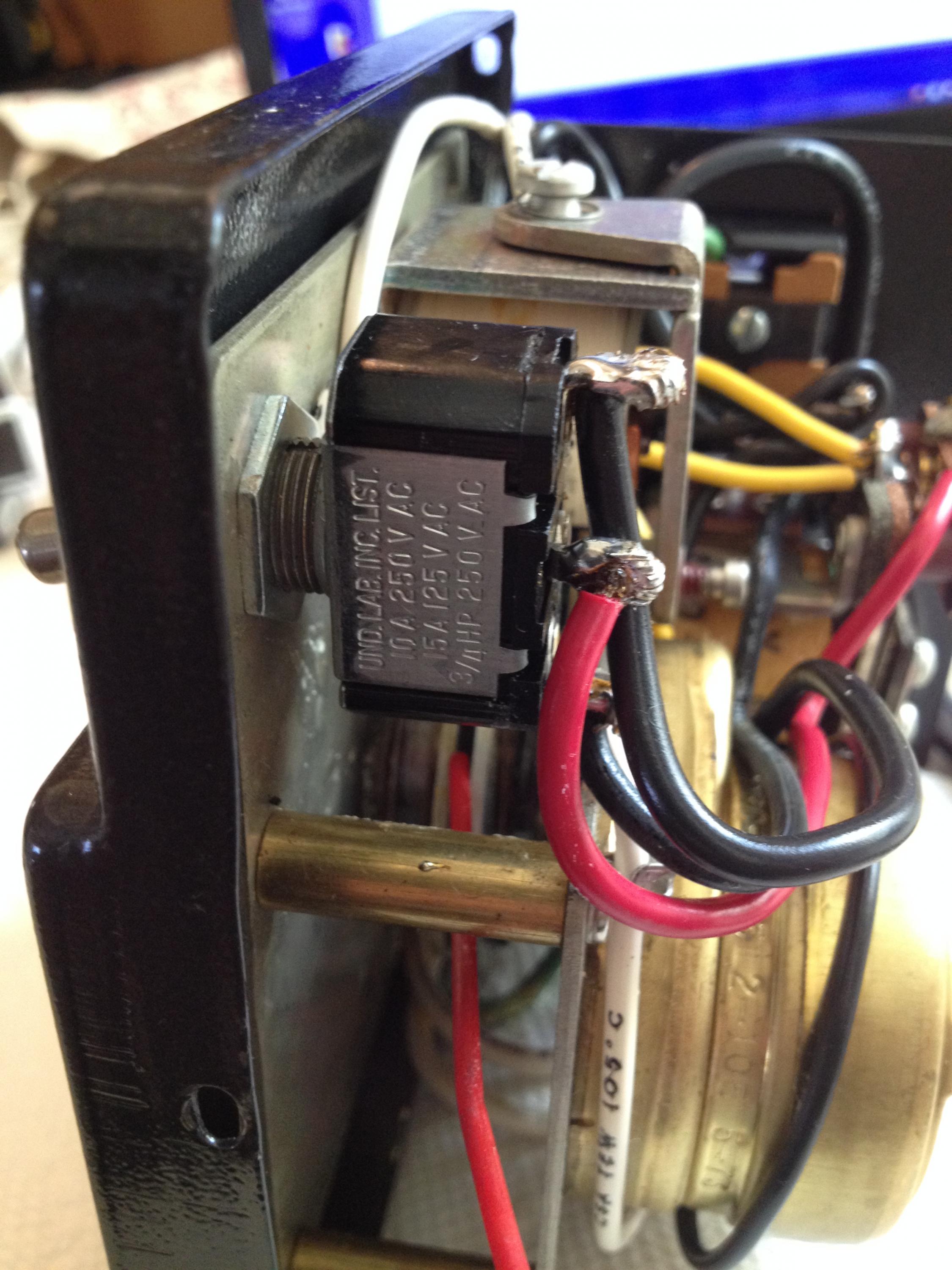

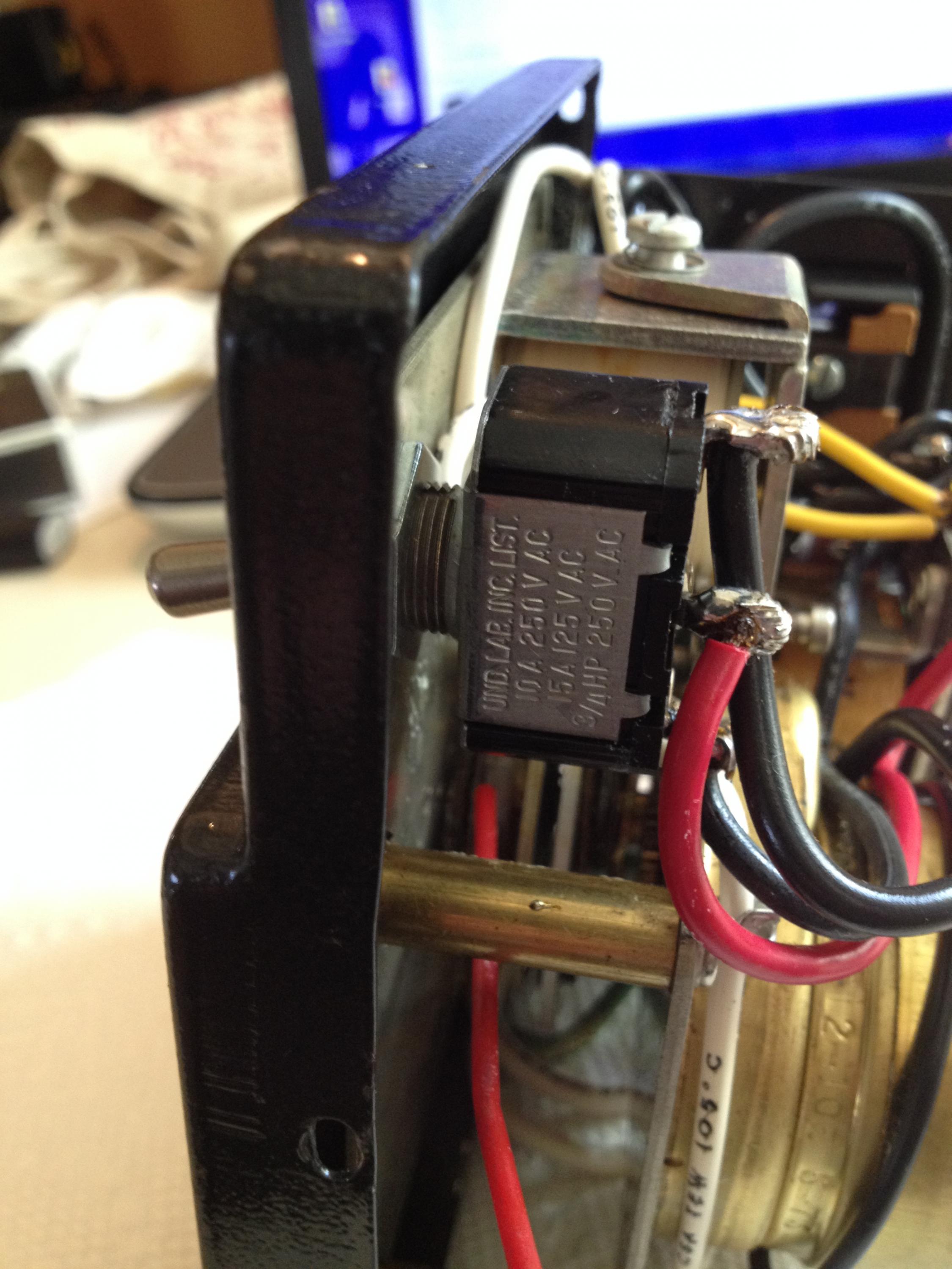

I realize this is an old thread but for future reference i had the same issue with my P72 and have fixed it. I applied penetrating oil and lithium grease in the two areas in the photo and it freed up the dial a lot. Its still a bit tough but a lot better.
