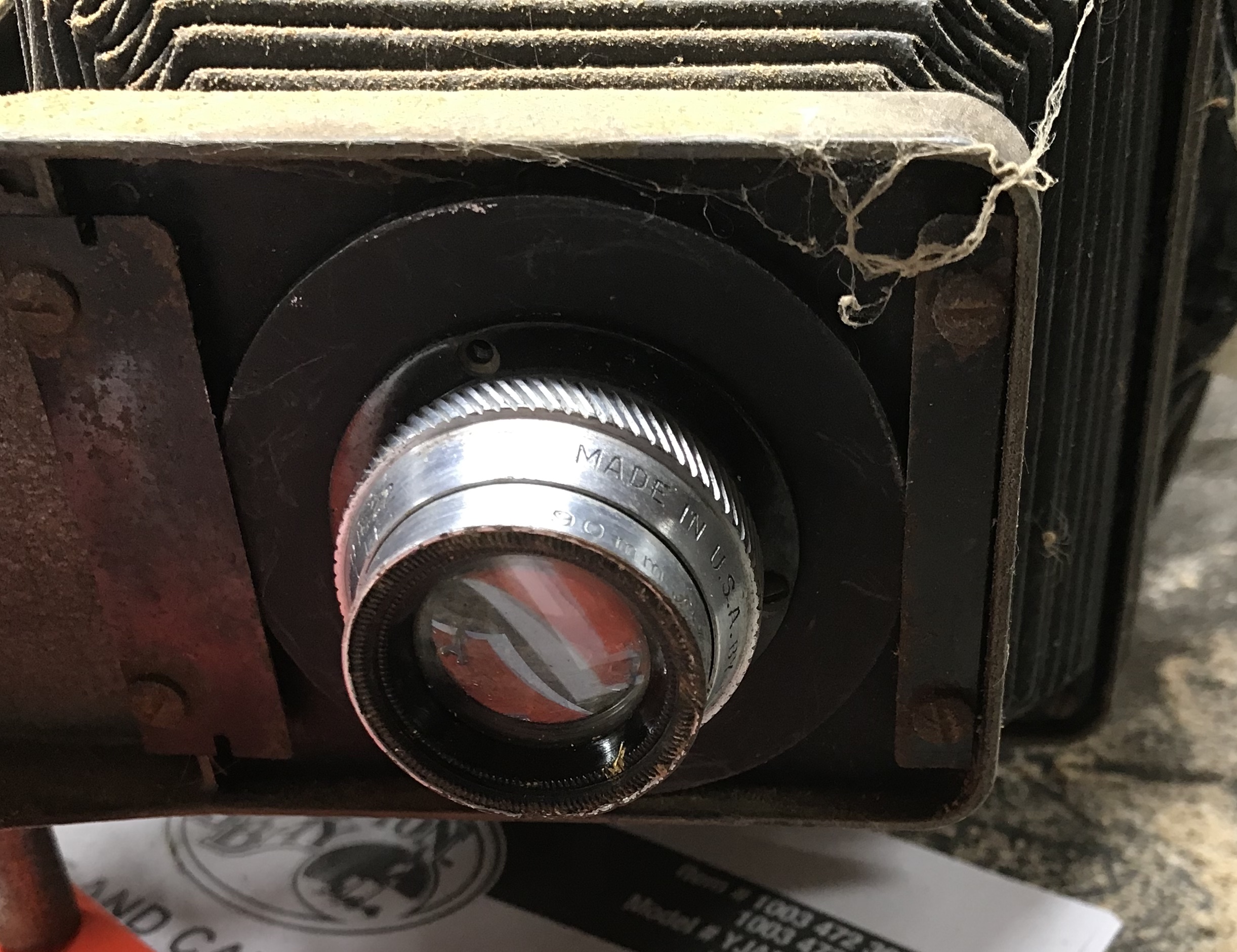

New to the forum (as of this morning!) and to B&W enlarging, , I plan on using a Craigslist rescued a vintage DeJur enlarger, the Versatile II, a condenser version.
It is missing lens board and lens, but between the well-known marketplace and some time in my workshop, I can deal with that.
The negative carrier to be recreated is more of a mystery (35 mm and maybe 6x6).
Do I use some glassless art board assembly, and replicate what I think is the original "paddle" shape as I see marks left on the machine, or just use a plain rectangle?
I am also confused by the thickness of the carrier "sandwich", that is, hinge part + thickness of film stop +....?
Another aspect of the rehab is geometry, how to make sure the projected image is square on?
glbeas
Sep 25, 2002
3,931
Marietta, Ga. USA
Ive had DeJur enlargers and found Beseler negative carriers worked just fine. Is the Versatile a medium format version? Carriers for a 23c would work fine.
The enlarger has side to side swings on the negative stage to square the image, just have to check and mark the joint for the proper location. Front to back takes shims under the mounts.
The one I have on a shelf in the basement had a round lensboard that slipped under the retainers not very securely. I think its supposed to have a small square one, might try one off a 23c, maybe cut it down if it doesnt fit.
