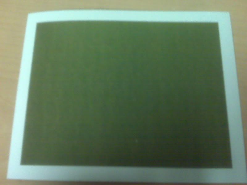

    I just recently bought a holga with the Polaroid attachment from amazon. As far as I know, I set up everything correctly, but for some reason all my pictures are coming out solid green. Can someone please help me figure out what I'm doing wrong? Thanks.

    First question, what film are you using, and under what conditions are you shooting? Holgas are slooww.My first thought is that you are underexposing? My next thought, have you removed the dark slide? It's a flexible piece of plastic with sort of a finger handle that sits in a slot ahead of the film plane. It lets you remove the back without wasting a sheet of film, but if it is in place while you are shooting, no light will reach the film. Welcome to APUG!

    I'm using film I bought from the impossible project, restored polaroid 100- 125i silk. The first photo I took outside and I figured it was either the lack of light or the temperature. The second picture I took indoors, with plenty of light and got the same result. And yes, I made sure to remove the dark slide.:confused:

    Hmmm, those are the simplest things I can think of. If the darkslide is out, and you have plenty of light ,with the back off, when you point the camera at something bright and look through the shutter from behind and trip it, do you see the dot o light?

    JB, just checked that out this morning and it was there.
    I'm stumped :sad:
