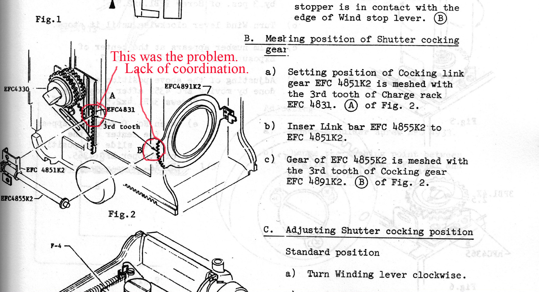

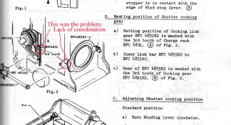

ricangel
May 27, 2013
4
Spain
Someone tampered with the mechanism and mounted it wrong.
Regards,
Ricangel.
