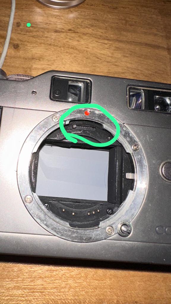

lanuevabasura
Jan 18, 2023
Argentina
Shooter
Hi everyone,
i had the same problem... after reading a lot and trying out many different things, i found out a solution, and it's VERY EASY.
basically, when the camera works without the lens and stops working when you mount the lens is because the camera is not recognizing that the lens is attached properly, so it stops working.
in my case, the whole problem has because this little pin was in the middle instead of in the left position, as you see in the picture I'm attaching.
You need to push it to the left to leave it ready to recognize the lens when it's attached.
hope this works!

warden
Jul 21, 2009
2,196
Philadelphia
Shooter
Hi everyone,
hope this works!
xb
What a first post! Welcome and thanks!
