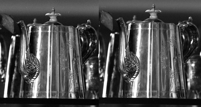

These are two identical shots, using the same camera, on the same film, with the same exposure. The only difference is one is developed in HC110B and the other in Rodinal 1:50
I am a newbie at anything other than HC110, so it's a bit frustrating to have to start all over with getting used to a new dev. I wanted something with a bit more "bite" so I tried Rodinal. I think it's obvious which was which.
Question is: Is this what I should be expecting? It looks to me not any sharper, just with more prominent grain. Any advice much appreciated!
Kodak Tri-X (400TX)
HC110B: 7' @ 20°C 1 inversion per minute
Rodinal 1:50 13' @ 20°C 1 inversion per minute
Negative scan, no processing.

At the risk of bringing the wrath of the rodinal church I will say yep rodinal is pretty ugly.

Nicola, Rodinal can be very good under the right circumstances. Not so good on another. YOu got exactly what should be expected. Both negs are sharp and Rodinal is grainier. If you want beautiful gran, Rodinal cant be beat, if you are contact printing and want very nice middle tones, Rodinal once again is excellent.
The best advice I can give you is not to expect a magic bullet with any developer. I would even say there is no such thing as a "best" developer, the developer is only as good as you are with it. From what I have seen you are doing very well with HC110, why mess with success?

Not obvious to me. I'd have to see the original negative. One frame appears to have foliage a trifle out of focus..?
Which is which?

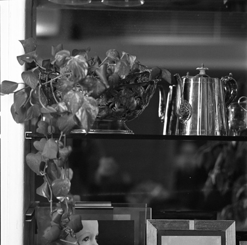

Ed: Really? I guess it's deceiving as we're all looking on different screens, but I thought it seems obvious which frame is which dev, given Rodinal's reputation for prominent grain... the left frame is the Rodinal. The full frame shot is also the Rodinal, just to place the enlargement factor into context. As for the leaf, tripod-mounted identical setup, so I'd rule out different focus in camera.
I'm afraid I got lost. The above indicates one frame developed in HC110, and the other in Rodinal. These were both were developed in Rodinal?

The frame here is a composite of two negatives of the same teapot - there is just one teapot in reality. The pot on the left is from the negative souped in Rodinal, the one on the right from the neg done in HC110.
