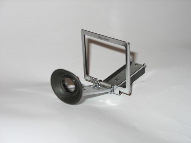

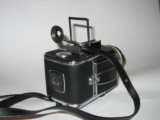

Here's the sportsfinder I have for my 500c. Mounts to the side of the body. There are inserts for different focal lengths (though I don't have any).
waynecrider
Feb 8, 2003
2,560
Georgia
Any of you have knowledge of what focal lengths were covered?
mgb74
Jan 24, 2005
4,769
MN and MA US
I don't know for sure, but suspect that since the frame itself is sized for 80mm, that there were inserts for 150mm and maybe 250mm.
