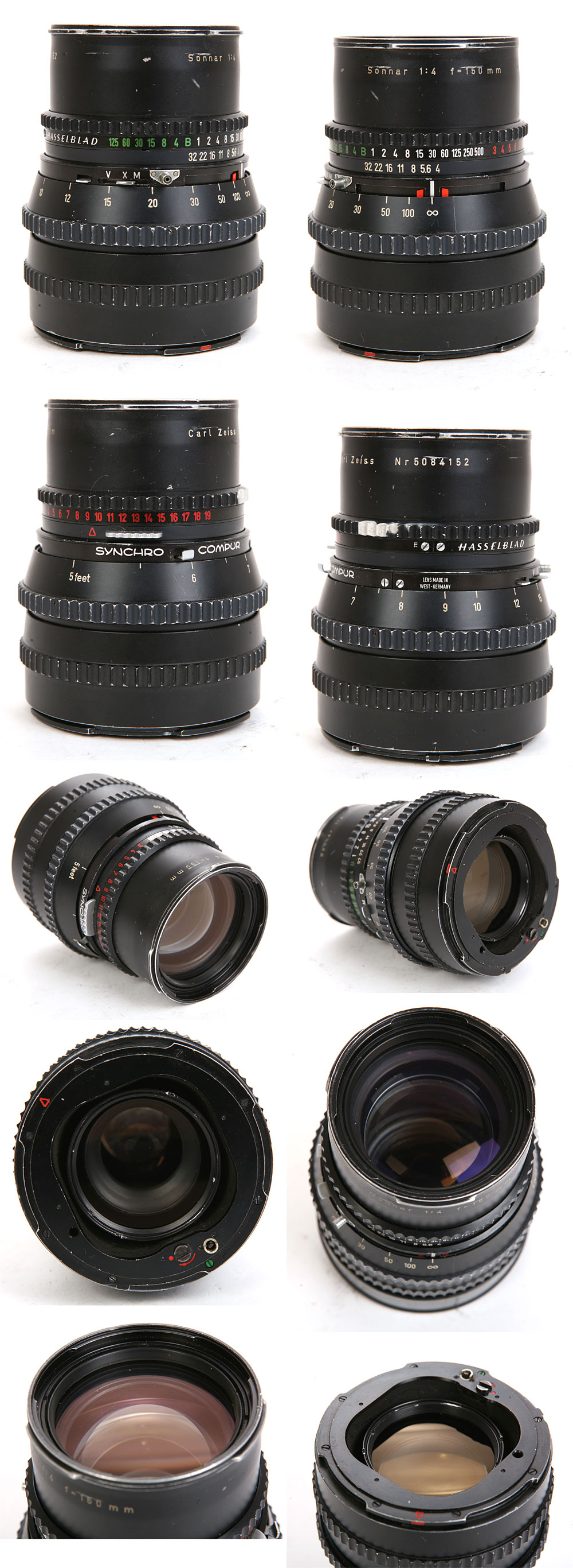

Barrel has quite a bit of cosmetic wear but mechanics are working great, focus smooth, shutter accurate and aperture functioning as it should. Front element has a few light polish marks which haven't showed up in any of the photos I've taken with the lens. There's a couple of specks of dust inside.
Overall a good performer if you don't mind not working with the prettiest lens on the planet.
- $170 plus shipping.
