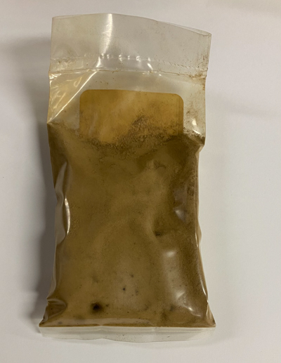

I recently acquired some old darkroom chemicals, and among it was a box of Formulary 130 developer. The glycin is brown with dark spots visible in the bag. Is it still usable, or should I toss it?

Craig, i'd say it's done. When I receive 130 from the Formulary, I immediately remove the glycin from the box and put it in my film fridge. I've never had it go bad when refrigerated.

I wouldn't use it. Fresh Glycin is a white(ish) powder. I keep mine in the freezer and after several years it's still fresh looking and works when I mix up some 130.

That batch has gone completely bad. Fresh glycin is either off-white or light tan. Extra jars of fresh powder can be kept good by freezing. As it ages it turns a light mocha brown; but somewhere in the deep chocolate zone it gets questionable.
I only mix enough 130 developer for a single day's session. An open jar of fresh glycin powder lasts at least six months before seriously oxidizing.
