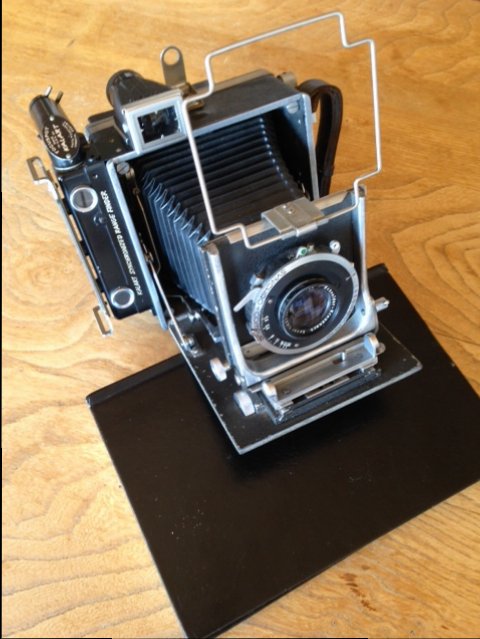

Annie
Mar 29, 2003
273

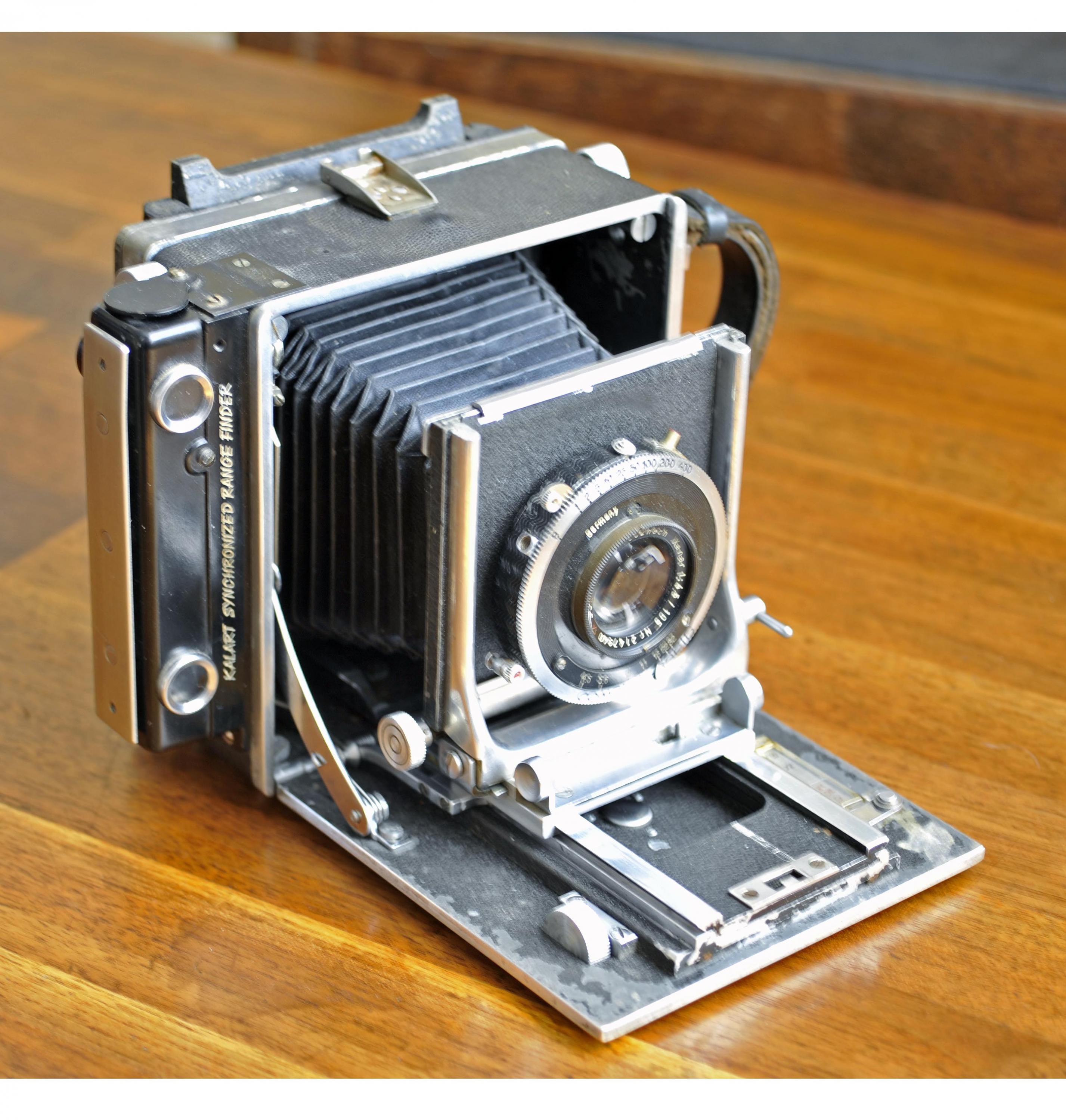

someone was inquiring about the Hacon and I couldn't get her photo attached to a private message... guess she wants to go public... let's see if this works
... best, Annie
gordrob
Jan 29, 2005
721
Western Cana
Shooter
Your Hacon seems to be in pretty good condition with all the parts intact. There weren't to many of these made and the serial numbers apparently started at 1000. I have passed the thread onto Chris who was probably trying to contact you. He has a lot more knowledge on the Hacon. The serial number on mine is 10021 and Chris I think is 10022. Out of curiosity what is the number on yours.

Gord... she is in lovely condition... all original and the lens is clear and the bellows lighttight.
She seems to be the baby of the group at 1037... Her birthday is June 26 1951 !

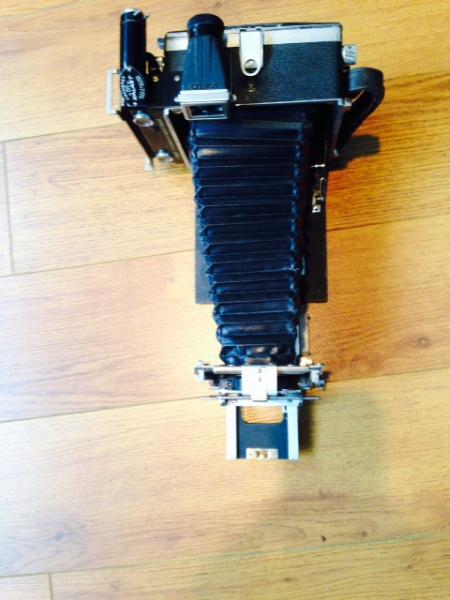

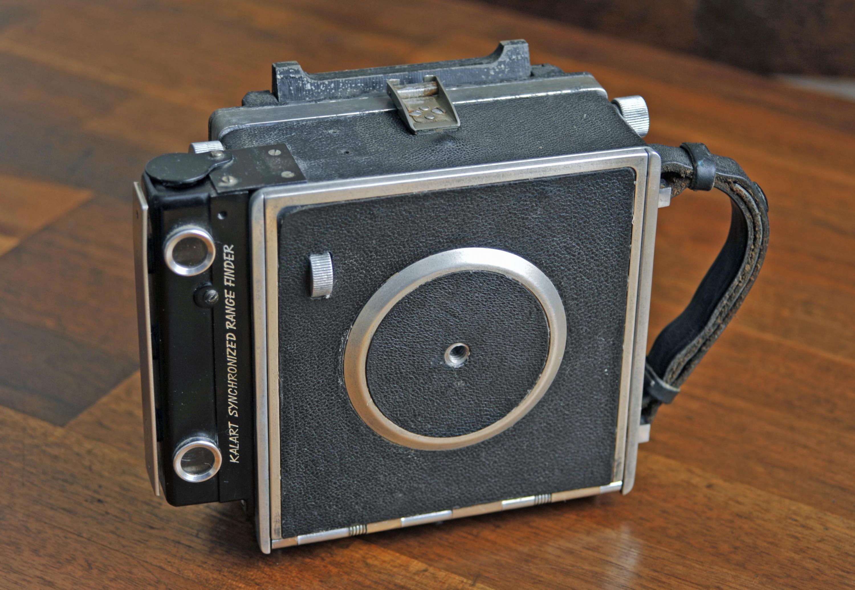

Thanks for positing the photos, Annie and for your help with the sports finder drawings, Gord. Here's a couple of photos of my better Hacon--with a Schneider 4.5 Xenar lens. The other one has a 101 Ektar but since Haca Supply had the distribution rights for Schneider in Canada at one time the Xenar seems like a better fit. We have now located five (!) of the 37+ cameras implied by the serial numbers including Annie's, two of mine, Gords, and Tony P's. Only Annie's seems to be complete now but a sports finder is being fabricated for mine and Gord will receive a Kalart shortly to complete his so there will be at least four complete ones in existence. We should invite any other Hacon owners to join our gang of four and see how many are still out there.
