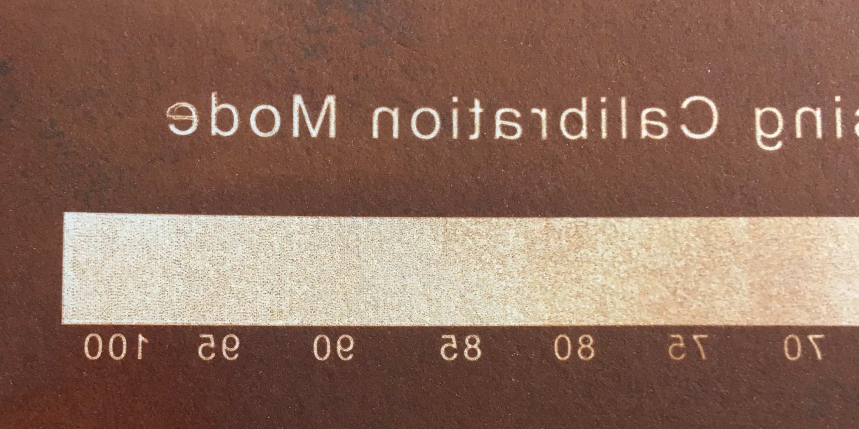

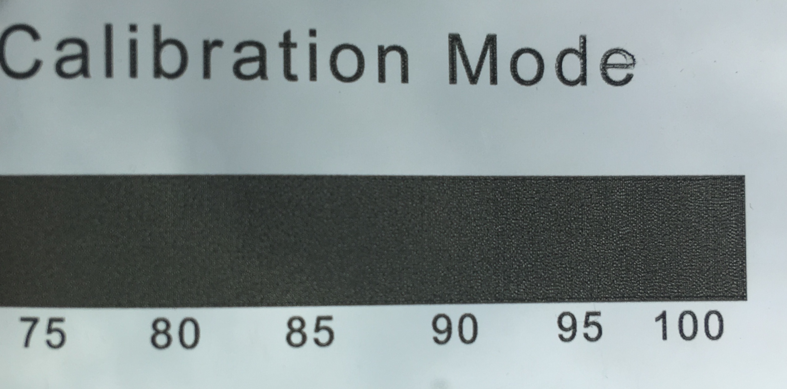

Hi everyone! I have an Epson 3880 that I want to use for digital negatives. I printed the QuadtoneRIP ink separation page, and in the densest areas of the ink it looks kind of grainy. (Edit: The photo black ink, that is.) Can I fix this by filling the gaps with more ink with COPY_CURVE? Or Is this a problem with the printer or the film? I'm using cheap film from Aliexpress, but it doesn't look smeared or anything.
Thanks!

I could be wrong, but it looks to me that you might have some alignment issues, given that the graininess is directional Have you checked that lately? I also think the opacity of the ink (MK? PK?) may not be adequate for your process. Have you looked at dialing in some other colors?

The ink is photo black. I ran a head alignment and printed another negative, and it seems better, but I haven't yet made another positive from it.

That was the problem. I printed from the new negative and it looked good. Thanks!
