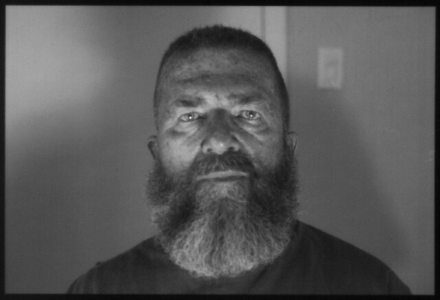

That reflective enlarger is one cool idea. I have enlarged paper negatives using a conventional condensor enlarger, and while the results are somewhat satisfactory, the paper grain comes through and it loses sharpness.
What I normally do is either scan or contact print. In scanning, I do NOT see the fibers of the paper, while if contact printing RC paper it's also not noticeable.
I do like small contact prints. Of course, the subject matter has to work with the size. A landscape, for instance, doesn't work, as the details are too small. But portraits or still lifes can be nice, especially if over-matted with a wide border.
Just today I was shooting selfies in a Minolta X700. Being as I rate the grade 2 paper at around 6-12, I set the camera to its lowest ISO of 25, then used +1 or +2 exposure compensation. Aperture priority, the camera determines the shutter speed. I developed them taped to the inside walls of a stainless 2-reel tank, minus the reels, tipped sideways and rotated as in drum processing. Only takes around 85ml of chemistry.
~Joe
Joe_Selfie002a by jvcabacus, on Flickr

I just realized that Joe had a thread about printing paper negatives a while ago. Interesting thoughts. But your post of your selfie kind of answers my question... the grain that shows up in a paper negative rivals film. Your selfie post looks like it could have been shot with Tri-X.
Sometimes when looking at others' picture postings it's hard to tell if the grain you are seeing is from the original or is it digitizing noise from scanning. You don't hear of people complaining that wet printing has made the print look even grainier than the negative so it leads me to believe paper emulsion has a pretty small grain.
