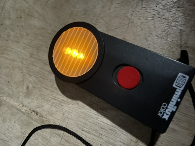

This is the candle light on the scale. For my next project I need to make it a proper mount, it was just held on by duct tape and a clothespin.
