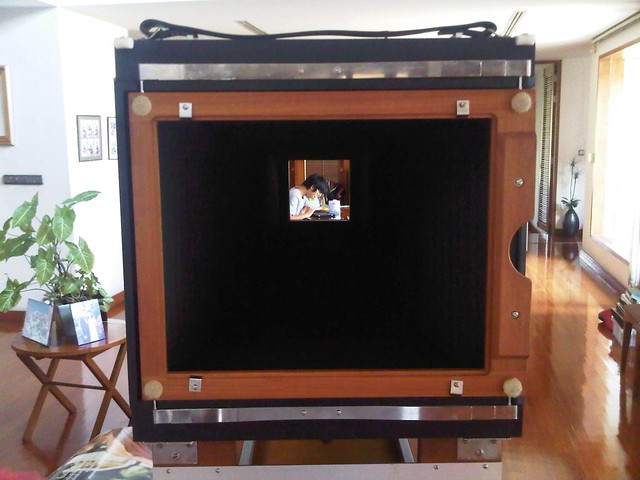

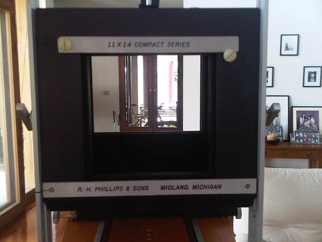

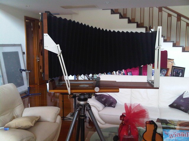

I just got the R.H.Phillips 11x14 Compact series. The full bellow extension is 30.5 inches.
I'm looking for my first lens for all purpose. Any recommendation is appreciated. My narrow list are Nikon 450mm, G-Claron 355mm, RD Artar 19".

Ohhhh just beautiful..... At first reading the title I thought you bought a "compact" camera. LOL. Now, that's really a 'compact' 14x11. :smile:

Dick Phillips makes beautiful cameras. Congratulations on a great lightweight beauty. Any of the lenses you listed are great for this format. Depends on how much you want to spend. I just picked up a 19" Red Dot for $80.00 in a barrel. Seller didn't state that it was in an aluminum barrel or I would have paid more. I don't need shutters as I shoot slow film and have had great success with inexpensive process lenses and x-ray film.

Beautiful "Compact" camera!

Great camera. Dick Phillips made the best and will still help you in retirement with repairs if needed. At 7x17 I only need a bit more coverage than your 11x14. My favorite and most used lenses are:
600mm Fuji C
450mm Nikkor M
12 inch (300mm) gold rim Dagor (lots of movement)
250mm Wide Field Ektar
My mentor with the 7x17 camera used a 305 G Claron, but I needed move movement. His best 7x17 friend used a 355mm G Claron for the movement, ignoring the size and weight. I could never find a 355mm G Claron and was very happy with the look of the Dagor. The 12” Dagor (300mm) has become my primary lens.
Enjoy your new camera.

Beautiful camera. Congratulations! Any of the three lenses you mention are good choices for the format. I have a Nikkor 450-M and a G-Claron 355. Both will cover with more than enough room to spare. Another option would be a Kodak Commercial Ektar 14". It is a bit faster, making for a brighter image on the ground glass for easier focusing. It also has beautiful transitions from in-focus to out-of-focus, and has very pleasing out-of-focus areas.

The 420mm Apo Nikkor will also cover. It's usually cheaper as most people don't know it covers 8x20. It is possible to put it into an Ilex 5 shutter if you don't want to use your hat.
I use the 600 Apo Ronar. Very sharp high contrast lens. My 300mm lens is the 12" Metrogon. While it gives nice images, it's heavier than hell so I don't think you should go there. I had to structurally beef up my 2D conversion so it wouldn't dform under the weight.

Don't forget to consider a Packard shutter for some barrel lenses that you may come across. These shutters are being manufactured in California and they have a web site. I recently acquired a 610 f9 Nikkor in barrel and set up a Packard for it that works just great. Big lens but you have a big camera.
