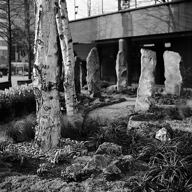

Thanks guys. I usually work pretty close, sort of micro-scapes. Often with a normal lens, usually with a 'wide-normal' like the 50/f4 Distagon. Here's an example of a recent shot (w/ a normal Planar) so you can see where I'm headed with this.
T.

Instead of the 165 Super Angulon, there's the 165/6.8 Angulon... Barely covers at infinity, but weighs a fraction. My 8x10" (18x24cm, really) kit consists of that and a 240/5.6 Symmar convertible. These are both old, cheap, better than their reputation, lighter than more modern lenses, and they are both in Compur #2 shutters - same size. That shutter size is uncommon and out of production, but they are reliable and should work well for several decades more.
I'm currently looking for a 300mm in the same shutter :wink:

You may find that your preferred angle of view changes with 8x10, Thomas. At least mine did. On 35mm, 6x6, and 4x5 I tend to shoot normal to somewhat long. On 8x10, my preference shifted to the wide side. If your experience turns out to be similar, the 240mm G-Claron previously siggested would be a good choice as your "normal" lens. For Wide (with a capital W), you might consider the 150mm Super Symmar XL, if the budget allows.

If you only consider the diagonals he would need a 203mm to equal the ratio of the 50 on 6X6. But in 4:5 I doubt he would have to stick to that to feel as wide as what is needed on a square format. Also most folks are surprised with an 8X10 that you usually back away somewhat from the really wide fields because with depth of focus of the longer lenses you just end up with 5" of asphalt to try to get in focus somehow. Also, the Calumet is a fine old camera and they are bargains for what they go for. A lot of thought and machine work went into them. But they really lend themselves better to long lenses and not so well to short. A modern field design like the Deardorff is sooo much easier and handier with wide field lenses. I'm nearsighted so I like to be inches away from the GG without an 18" bed in my way.

It's also true that you will probably want to stand back a little farther with your tripod than you did with the Rollei, so I would not sink big bucks into a lens that you may not use as often as you might think.
Consider the 210 Angulon in a Copal 3. Fairly light, opens to 6.8, and gives lots of movement on the 8x10. If you don't like it, there should be plenty of
