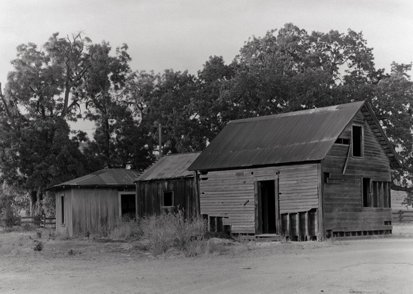

I still think if all you want is an old time ortho look, why hassle with coating mylar or unexposed sheet film with liquid light when you can buy it already made for you. Here is a shot made on Ilford Ortho Plus. I rated it at ASA 25, and souped it in D-76 1:1 under a red safelight. A box of 4x5 (25 sheets) is $16.50 from B&H. To me it is more economical in time and money to just buy the film. That's my 2 cents.

Kodak professional copy film is Ortho Also. Only thing I don't like about it is its pretty grainy for an EI25 film. How is the Ilford for grain?
