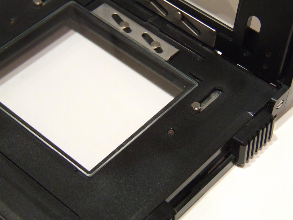

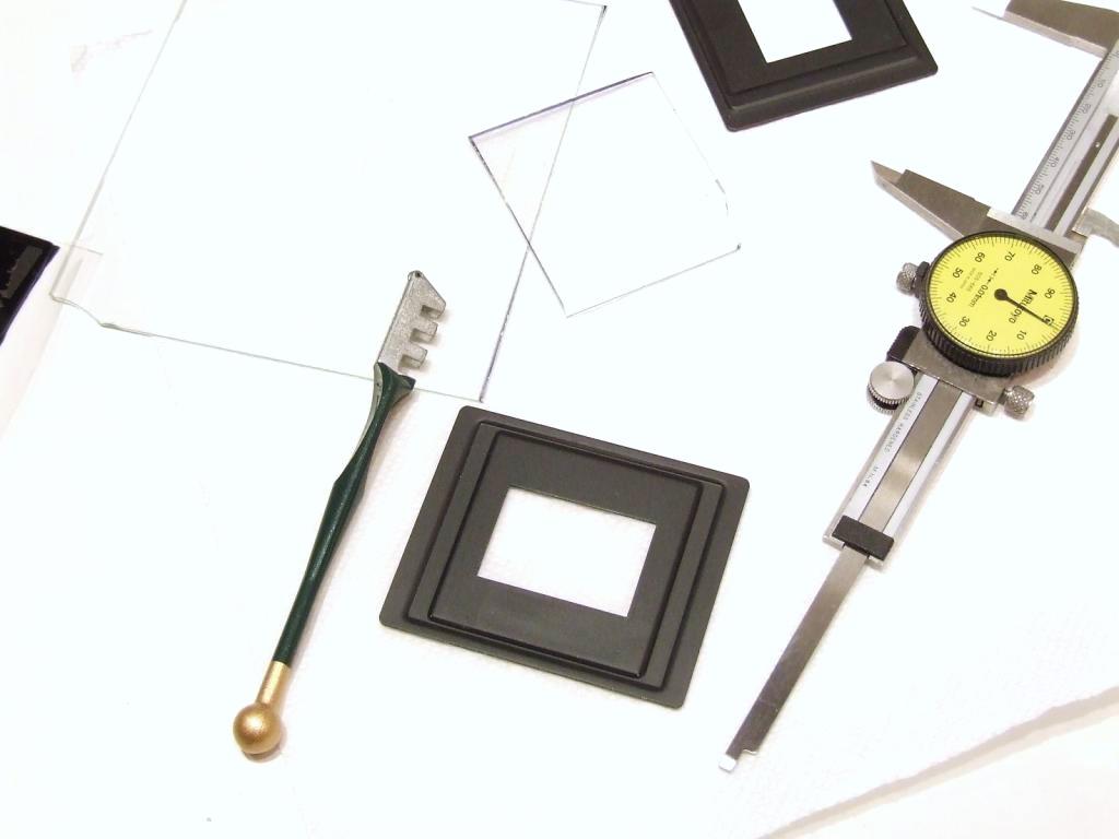

Not sure about your negative carrier, but on the Philips, the glassless inserts can be replaced with glass. In this case I used some scrap anti-newton glass and cut two pieces (one clear and one AN) to the corrects size to fit the negative carrier.

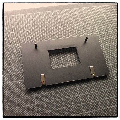

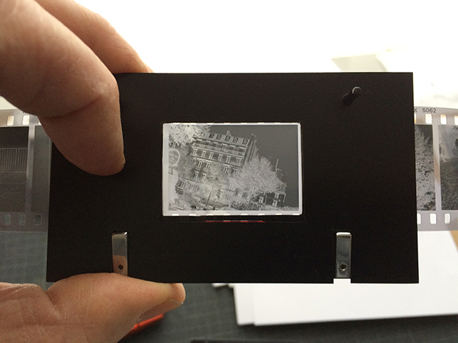

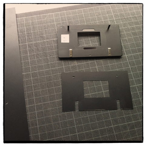

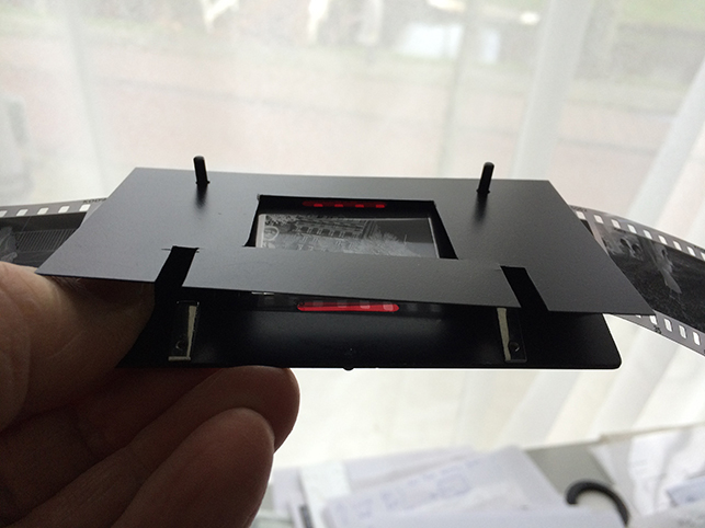

To find the right negative holder at a good price needs time and patience. But in the end you will always succeed. Save your searches and you will get automated emails when something is put online. In the mean time Ian is right: just prevent your film to touch the upper glass. That is so simple, anyone can do this and it takes 5 minutes. Use the thin-but-still rigid black carton, or black pvc sheet. In the pictures you see what I made for the Focomat Ic or Valoy II that lack the AN glass. The set up is a little different, because here the condenser presses flat the negative and Leitz made an AN glass ring that slides on to the condenser. But the principle is the same . . .
