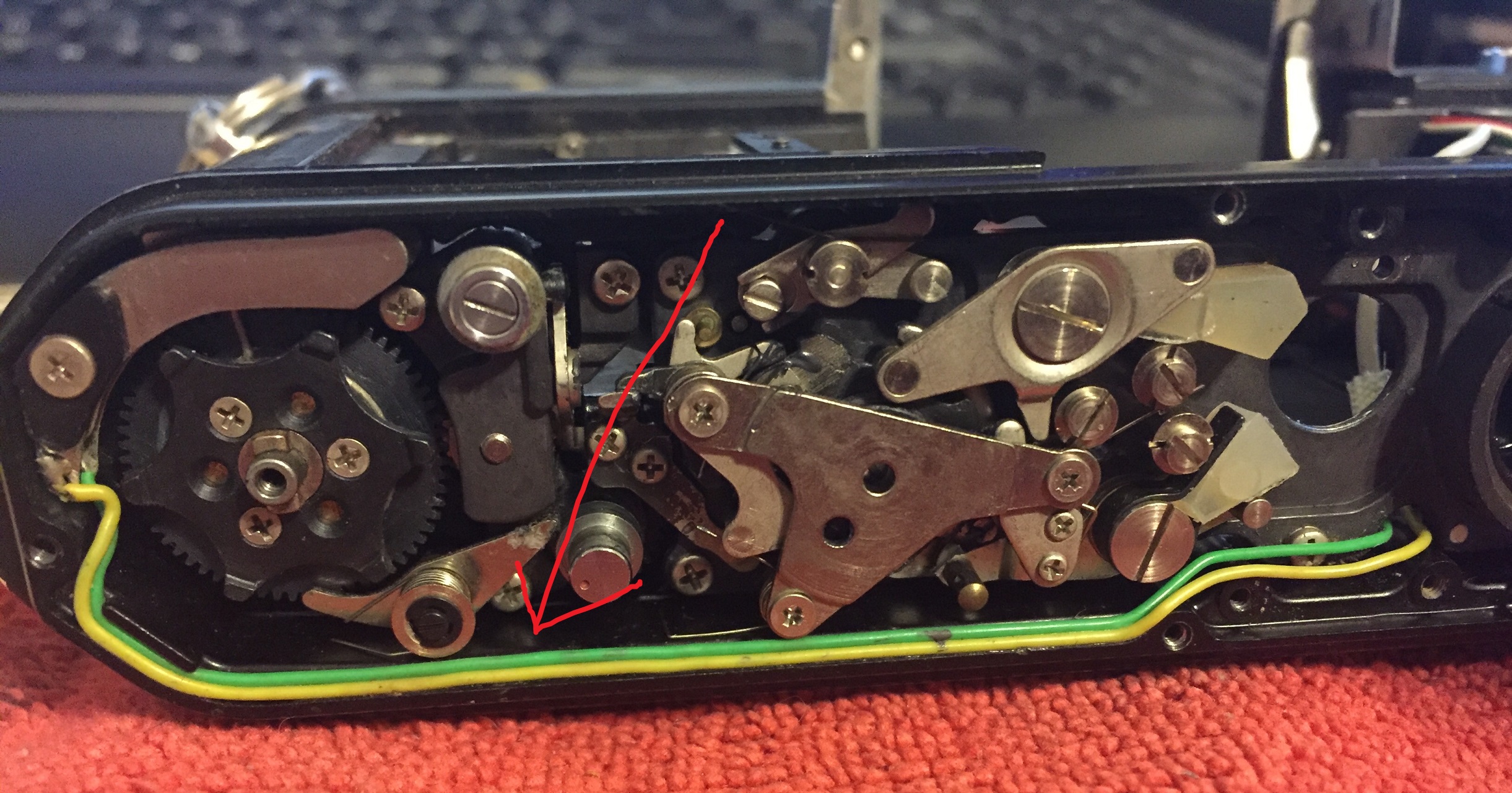

Looked at the repair manual; no help.
I need the green/yellow wire that goes from battery holder to the advance turn-on reed switch.

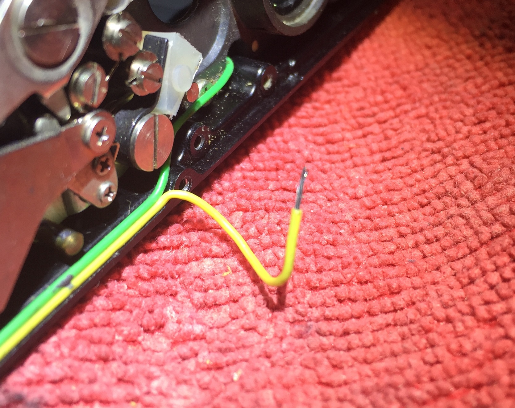

The old wiring simply refuses to take solder; it just burns and turns black. There was corrosion on the connector tab, so it probably wicked-up the wires and corroded it for a distance. Anyway, I'd like to totally replace them along with a NOS battery holder I found.
Thanks.

Best I could do right now. Jacket measures 0.81mm by calipers...

Wondering now if it's not 30 or even 32 gauge; it's really small and 2 of them have to fit in a 2mm channel...

The current these wires carry is really small and practically anything would do, but wires smaller than about 24-26 gauge are a PITA to strip and solder in my opinion. It's not 20 gauge - 0.81mm was the diameter including the insulation, while a 20 AWG has conductor diameter 0.81 mm. Try 24 gauge.

Thank you Shuterfinger and Reddesert for the help. Another member will graciously be sending me replacement wire that seems to be identical in size.
I started out to just clean the low speed escapement of this old F2, but as I am learning, 50 year old plastic and wiring does not like to be disturbed AT ALL.

Thanks to Photrio member John Koehrer who sent me a couple of sections of very fine wire, I was able to strip out the glued-in wire and replace it when I replaced the battery chamber and the meter functions!
Whew! That was nerve wracking! Nikon really didn't want that wire wandering, so they pasted it down with some clear adhesive that forced me to take an X-acto knife and cut it out. It lies in parallel with a second wire for the battery circuit, so it was very difficult to NOT cut the other wire.
Got the slow speed escapement cleaned and back in and the camera reassembled and it fires on the slow speeds that were just locking-up, but they now are all around 1/15th of a second instead of 1, 2, 4, and 8.
Some progress, but not complete yet...

Thanks! The F2 battery circuit is pretty simple, but threading the wire in and around the body is something that takes careful study; there is little room for error and the wire must be almost exactly the right length or it will foul the mechanism in certain places. Frankly, I resolved that if the repairs I did last night failed, I would just use a meter but I got lucky...
