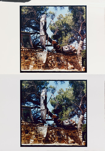

A couple of times we speculated on how those two papers compare . Since at this time the status on Fujiflex production is unknown/uncertain, this comparison might prove to be utterly meaningless, but anyway...
Fujiflex top, Maxima bottom.
Same time and filtration for both prints:

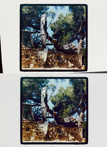

One of test print of Fujiflex which I then tried to match on Maxima. After second test print on Maxima I knew that with two points less yellow I would probably be so close to Fujiflex that I could not tell them apart (if it wasn't for the completely different surface):

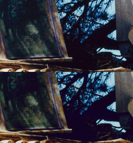

Only difference was in deep shadows. Maxima curiously had a slight blue shine (yeah, shine in deep shadows, but I don't have a better word). And it's not just in scans, if you look Maxima print at a just the right angle in strong light it's definitely visible. My Maxima is almost 2 years old (although it was frozen for about a year of that time):

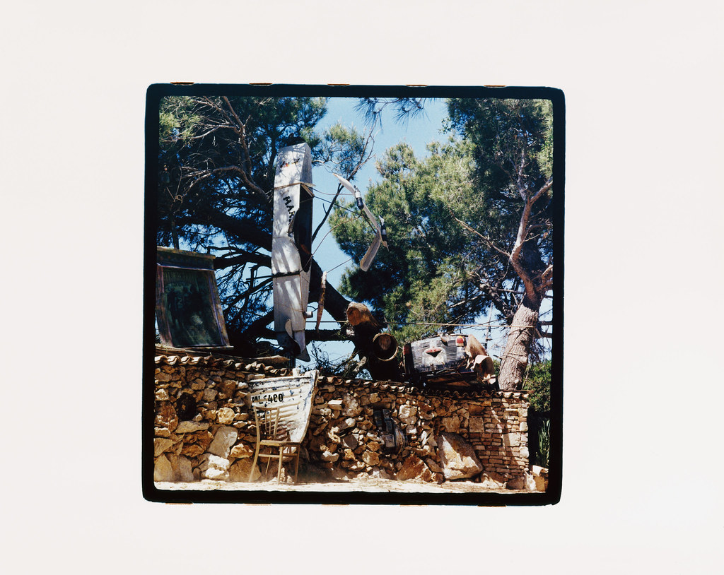

Final print:

Yeah, that looks really close indeed. As you said, the base is totally different, but it's clear that the imaging characteristics are very similar. The slight difference in yellow could also be in part due to aging effects.
The blue shine I expect is an artefact of the surface characteristics of the Maxima paper; have you compared it side by side with DPII in this regard?
