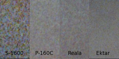

Over at Hybridphoto i believe they sometimes are engaged in what they call "pixel peeping", i guess we could do the same here on apug, but instead call it "grain peeping". I followed my own advice in this thread earlier, i raised the head on my enlarger to what would have made a 63cm wide copy, 17,5 times enlargement. Put a frame containing a solid gray area in the film holder and focused my Componon-S, then took some test strips and exposed. Did this for Superia 1600, Pro 160C, Reala and Ektar. Then i scanned the strips at 400ppi and cropped out a 100% zoomed part from each strip.
Most monitors today have a resolution from 90 to 110 pixels per inch, around 100 in average as a guess (i am at 96). A 400 ppi scan looked at in actual pixel size on a 100 ppi monitor is a 4x enlargement. The original 17.5x enlargement is thus enlarged 4 times more in the crops below, that is 70x enlargement viewed in an average monitor. Reala and P160C is very close..
(edit)
All of them shot at box speed. The gray area is actually a small part of a IT8 target (vary handy to have a frame of when dialing in a base filtration ans exposure).
