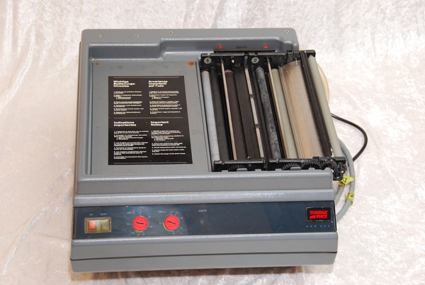

PhotoTherm ACP-302 print processor. Very compact. Uses 2.4L solutions to quickly process RC prints up-to 30x40cm.
I'd like to trade it for a medium format camera or a 4x5 field camera with holders and a lens. Let me know, what you have. I will cover shipping of the processor in the continental US. For international shipping, PM me for a quote.
Condition of the processor:
Retired from college use. I cleaned it, tuned and tried with water. The water heats up to 35C in about 20 minutes. I ran about a dozen sheets of paper through. Everything seems to work as supposed to. The machine will not win beauty contest, but it seems to work reliably - paper runs smoothly, and solutions circulate.
The only things I notice about it: The rubber foam seal near developer inlet may need to be replaced in the future. The rollers in blix chamber were shaved to round shape. I did not want to clean it again, so I did not use chemistry in the machine. If you concerned, I can do it before shipping and run a few real prints through.

How many baths does this processor contain?

I thought so too, but thought there may be a hidden tank.
I'd really be interested if it was a three bath unit, as I would like to use separate bleach and fixer baths.

RA-4 doesn't need separate bleach and fix baths.
Tom
I am aware of the common standard process with blix, and I do no want to use it if I do not have to. Separate is better with film, so it must be better with paper as well. All of my prints thus far have been done with separate baths in a Kreonite (community lab).

Rick,
I was hoping for something that takes modern film. My dream camera is Mamiya 7, and I would be willing to add some money in the trade. Or maybe one of Fuji rangefinders.
2F/2F,
this is a two bath processor. Actually, you can't separate bleach and fix in a roller machine because
in these machines paper moves at constant speed and all processes must run in the same time. When you separate
bleach and fix, the bleach time needs to be increased relative to development. It's just not going to work.
I'm curious, why do you want to separate blix in RA-4? The process is tuned for blix, so theoretically, you should not
get much better results by separating chemicals. Can you elaborate a bit more why you want to do this?

We use a separate bleach and fixer in the Kreonite roller transport processer that I usually use when I print color. Maybe it is not "necessary," but surely it is "better" for the same reasons it is with film.

Presuming bleach + fix is better than blix for RA4 because it's (supposedly) better for C-41 is a logically flawed assumption. Where would you even find it? Maybe for a Kreonite user (Read: huge commercial processor) there are suppliers that could supply that but likely it's done not due to it being "better" but more likely due to it being cheaper. The bleach can probably be recycled and save some cost. Big commercial processors (e.g. someone who would own a Kreonite) are more concerned with cost and throughput than top-quality.

It is not a "logically flawed assumption." The content of the assumption may be incorrect, but it is certainly arrived at logically. It follows quite well that, due to the similarity of C-41 and RA bleaches and fixers, the advantages of separate baths for C-41 may also be advantages for RA.
All I ever said was that I WANT TO USE A SEPARATE PROCESS! When asked, I said why. I also said that this is how I currently process my RA prints, so YES, it is done, not only period, but in a roller transport unit. If you don't want to, then don't! I never tried to talk anyone out of the one-solution process, which I am sure works just fine, and I never tried to talk anyone out of buying this processor. I asked a question, the answer of which helped me determine whether or not his may be an item in which I am interested. When pressed, I gave further answers. That is all. Now, back to selling the processor.

2F/2F, what chemicals do you use for separate baths and what times/temperatures? I think I want to try it myself to compare the results.

Hi,
I actually JUST found out that the Kreonite uses separate baths last month, and will not be able to get the answer of what chems until the next session begins (late August). I think it may be Fuji, though. I always assumed they used a Blix process, and was surprised to learn that they do not, so I am incredibly curious myself!
PE here on A.P.U.G. has also said that C-41 bleach and fixer will work on RA paper. You just have to experiment to find the proper dilution.
I believe that there are also a few SKUs at B&H which are called Blix Part A and Blix Part B. I am thinking that they may just be separate bleach and fixer, though I will call Kodak and verify that. Even so, I don't think B&H will ship them.
