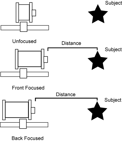

Both of them simply adjust the distance between the lens and the film to bring a subject at a given distance into focus.
Leaving the back in place while moving the lens towards the subject has the effect of moving the camera slightly closer to the subject the subject. Moving the back towards you and leaving the lens in place has the opposite effect.

Here's a quick drawing to illiustrate what I said in my previous post.
Of course, the bellows extension would be slightly shorter in the back focused situation
